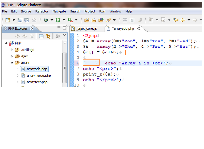

Eclipse IDE shows ">" at every indentation. Please refer to attached picture.
Every time I press tab, ">" is showing in my project.
My eclipse version is 3.7.2 and using "PHP perspective".
How can I solve it?

As you can see at the dialog linked from Preferences->General->Editors->Text Editors->Show whitespace characters, Eclipse uses "≫", "¶" or so as whitespaces.
Your screenshot is different from Eclipse.

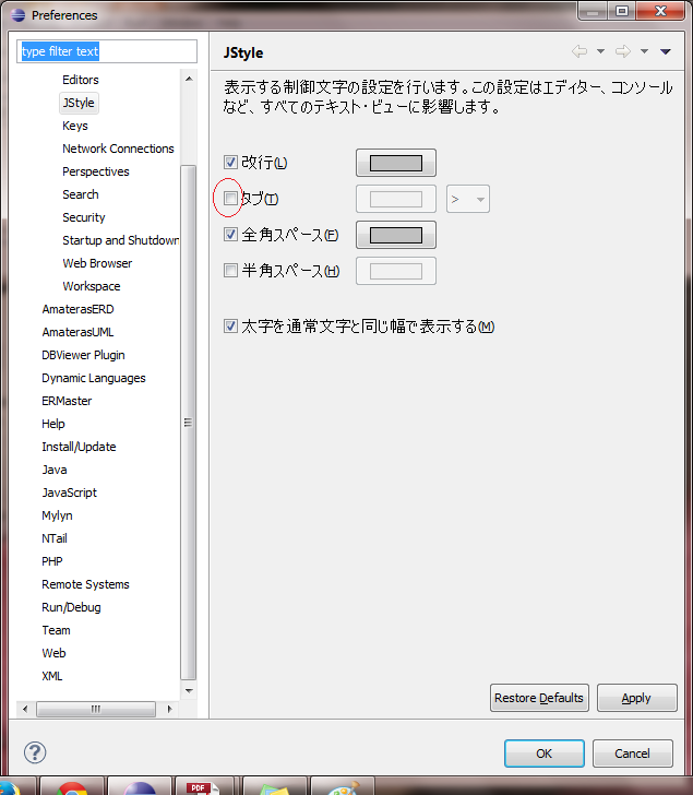

I'm guessing you must have a third party plugin such as JStyle for example. Have a look at Preferences->General->JStyle if it is there.

I now checked my eclipse setting as Toshihiro Izumi's post and it is useful for me.
I just turn off => Preferences->General->JStyle-> ...(T). (Please refer attached file) Smile
