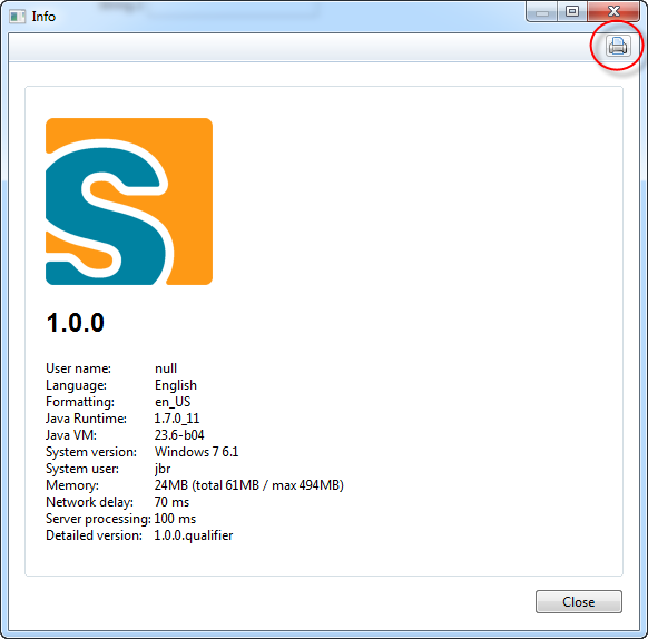

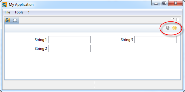

We are evaluating the possibility of adding ToolButtons in a Scout Form. Here some intermediate results to check if there is any interest.
The current solution can be used without any Scout runtime modification. It is realized with custom code to overload some functions (Form in the scout model, SwtEnvironment...). We haven't published the code anywhere, but I am happy to share it, if someone wants to have a look at it.
Scout model
Tools buttons for forms could be defined as inner classes of the form class:
  @Order(10.0)
  public class AboutButton extends AbstractToolButton {
    protected String getConfiguredText() {
      return TEXTS.get("About");
    protected String getConfiguredIconId() {
      return Icons.About;
    protected void execAction() throws ProcessingException {
      ScoutInfoForm form = new ScoutInfoForm();
      form.startModify();
Of course you need to use a subclass of AbstractForm (say AbstractMyAppForm) and add code that will check for the presence or not of ToolButtons in the form.
* getToolButtons()
* getToolButton(Class<T>) where "T extends IToolButton"
* additional code in initConfig() to look for the ToolButtons
SWT rendering engine
For now we have added some code to be able to render it in the SWT (views and dialog):
index.php/fa/17135/0/
index.php/fa/17136/0/
