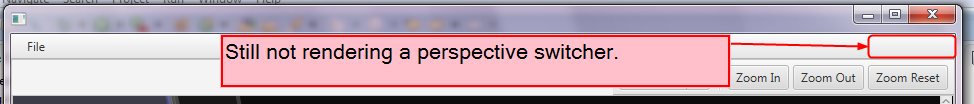

I had already tried to add a ToolControl trim contribution but so far I have not been successful: I added a Trim Contribution where I set the parent id to that of the Window Trim. The Window Trim contains a Toolbar with "fillspace" tag (which does work nicely). But no matter what I add to the Trim Contribution nothing appears. I tried a Toolbar with some Tool Buttons, a ToolControl with a class just creating a label and now a ToolControl with the MyPerspectiveSwitchControl from your answer, to no avail.
