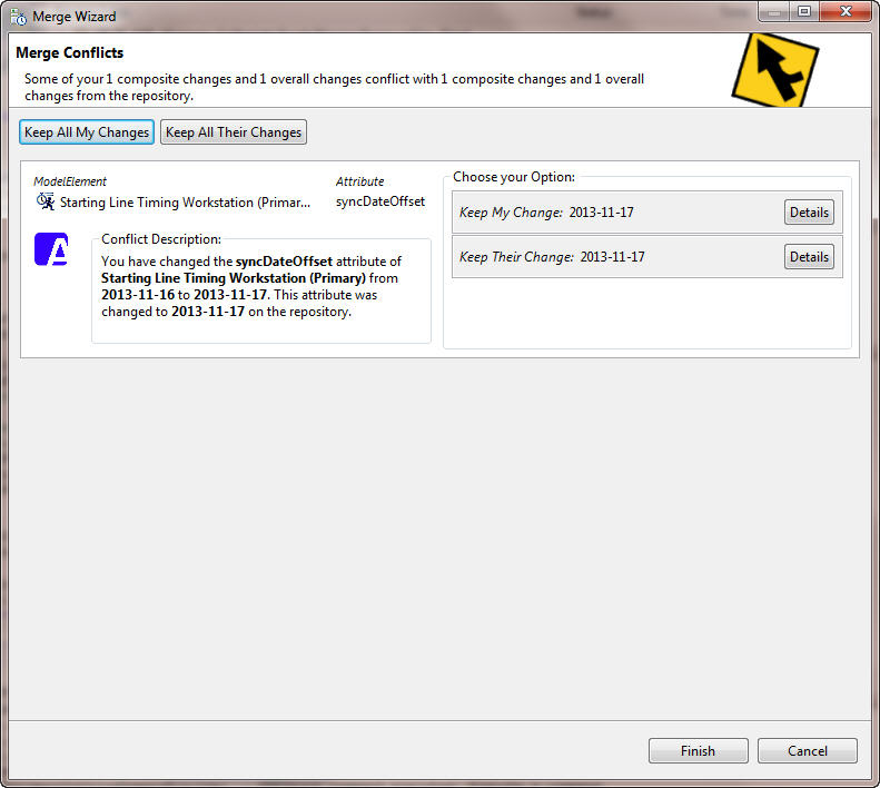

My application uses a custom Date class and when two EMFStore clients
attempt to commit the same date to the same EAttribute in the same
EObject, EMFStore sees it as a conflict. See the attached screenshot.

What happens in your case now is, that a conflict is created because
there is an incoming as well as a local change that both
make the same reservation (the syncDate attribute), therefore EMFStore
decides that a conflict must exist. What is missing here, is a
fine-grained resolution of the conflict, i.e. we would need to look at
the conflict and check all involved operations. If we see that both
operations come to the same result, we would be able to neglect the
conflict. But this ain't currently the case.
