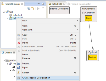

I've a special use case. We've so far a combined EMF/GMF Editor where users can create models. Now we want to have another editor for further processing. For this case, I've an org.eclipse.ui.menus extension point, so that a user can right click on the EMF File and a new file will be created (see image)
index.php/fa/16665/0/
The file extension (.plc) of the created file is associated with a MultiPageEditor, where one page should display the emf tree as a checkboxtreeviewer and the other page should display the selected elements as a tree.

Thx Ed for your answers. I tried now for hours to uderstand this, but I don't really get it how to assign an existing resource to a new file. At the moment I've in my org.eclipse.ui.menus DefaultHandler the follwoing:
