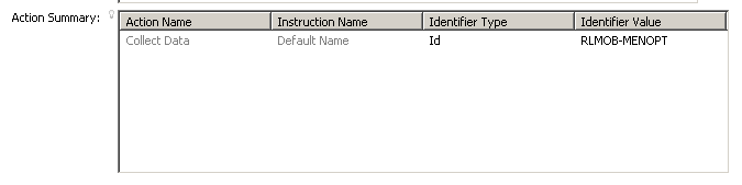

From the definitions above, I get the following list which is what I am after.
index.php/fa/16689/0/
