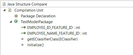

For the generation I still use the xpand templates.
I have notice that the generated code with the template xpand is not equal to that generated with template xtext.
I am attaching a simple example.
