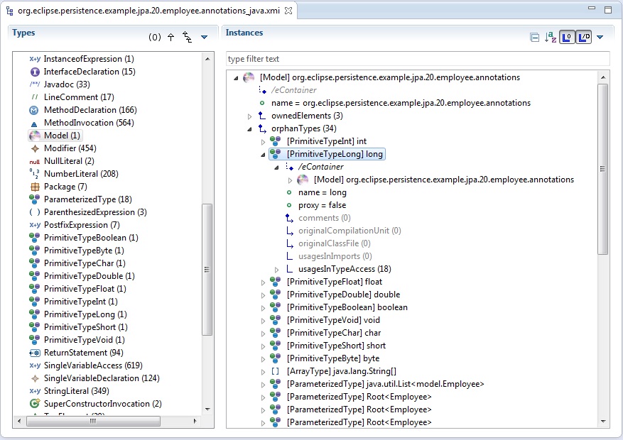

Browsing the Java model, you can see that the PrimitiveTypeXXX elements are set in the orphanTypes reference of the Model element.
Generally, to see the actual container of a model element, you can check its computed /eContainer reference in the MoDisco Model Browser.
index.php/fa/16105/0/
