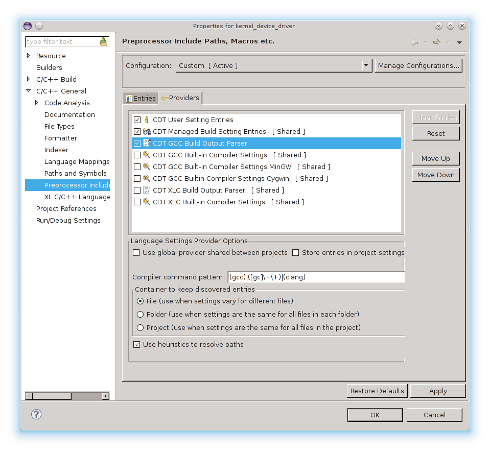

I'm trying to setup CDT so that I can work on a little kernel driver tutorial I've found.
CDT offers the "Build Output Parser (BOP)" options which is supposed to extract the include paths from the build output.
What options do I have to set for this to work with gnu make and gcc? Unfortunately I haven't found anything on the internet about this topic.
I'm currently using CDT 8.2.0.

unfortunately I don't see any hints on how to configure CDT and the make and GCC command line parameters. I have uploaded the current project and build output with a screenshot of my current Build Output Parser settings.
Re: Use Build Output Parser (BOP) to find include path [message #1083107 is a reply to message #1082901] Fri, 09 August 2013 09:35 Go to previous message
It considers lines that start with "gcc" and end with C file being compiled. Your compile command is embedded into shell script. If you manage to print the compile command in build output on separate line it should parse it. Also, the C file has to be a part of the project.
