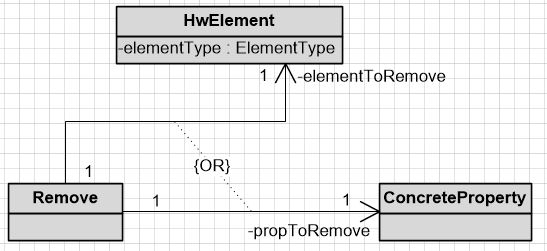

what's the best way to realize a UML XOR constraint with EMF. The following model gives you an idea what I mean:
index.php/fa/15638/0/
Cheers,
Phil

Phil,
The only way in the core framework is to define a constraint:
http://help.eclipse.org/kepler/index.jsp?topic=/org.eclipse.emf.doc/references/overview/EMF.Validation.html
This case could be handled as an invariant that tests that at most one
of the two features is non-null. Or it could be done as a named
constraint on the Remove EClass that tests the same thing.
On 18/07/2013 9:00 PM, Phil H wrote:
> Hi,
> Cheers,
> Phil
