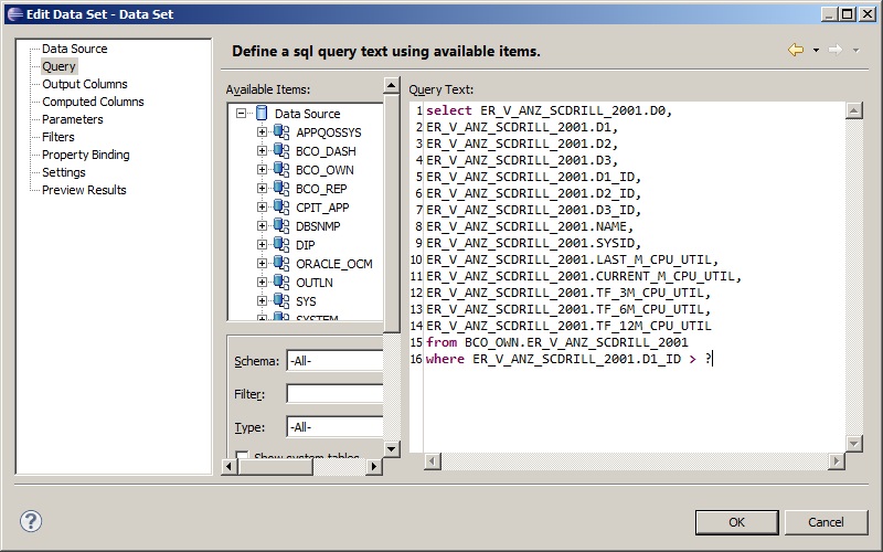

I'm new on the comunity and working with BIRT. I've a question and I haven't been able to find the solution, sorry if it's duplicated. I'm trying to create a data set parameters from a jdbc Data Source.
When I create a data source jdbc and select org.eclipse.birt.report.data.oda.sampledb.Driver (Classic Models Inc. SampleDB Driver), I have no problems. I create a data set associated to this data source, and later I add a parameter marker to the query. Finally I can see parameter marker on "Edit Data set/Parameters"
As example for query:
select CLASSICMODELS.CUSTOMERS.CUSTOMERNAME
from CLASSICMODELS.CUSTOMERS
where CLASSICMODELS.CUSTOMERS.CUSTOMERNUMBER > ? (I'm able to associate the parameter marker to a parameter created )

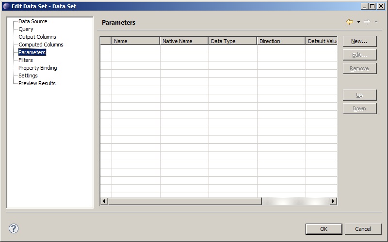

However if I select oracle.jdbc.driver.OracleDriver or oracle.jdbc.OracleDriver, create a dataset associated, and add a parameter marker to the query, I can´t see parameter marker on "Edit Data set/Parameters".
Birt version is 4.3.0.
Oracle version is 11.2.0.1.0 - 64bit
jdbc ojdbc5.jar and ojdbc6.jar

Re: Problem creating parameter marker [message #1070980 is a reply to message #1070690] Fri, 19 July 2013 00:44 Go to previous messageGo to next message
Sounds like a possible bug. Does it work for a workaround to simply add a dataSet parameter for each '?' in your query?
icon14.gif  Re: Problem creating parameter marker [message #1071050 is a reply to message #1070980] Fri, 19 July 2013 04:31 Go to previous messageGo to next message
Hello Michael,
Sometimes the most logical and simplest response, is the solution. Yes it seems a bug. I think that I had tried it, but after your response, I tested it again and it worked.
Thank you very much.
