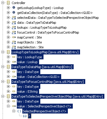

so my problem now is, that i tried to resolve the errors and now nothing is working anymore Sad
i put everything into one ecore again and try to generate it with texo, but it skips me some eclasses (which are a construct to represent a hashmap - this is my main problem here, as texo does not generate function, and now it even skips generating those classes)
here a crop of my ecore, the selected classes are ignored(not generated) by texo
index.php/fa/15020/0/
PS: in which part of the forum do you read texo threads? EMF / EMFT / EMF Tools
Re: Use Texo and EMF genmodel together [message #1060155 is a reply to message #1060148] Thu, 23 May 2013 07:08 Go to previous messageGo to next message
Hi Ludwig,
I read EMF and EMFT.
These classes are skipped as Texo generates parameterized Map declarations in the java classes, so there is no need for
a separate java class to represent a map entry.
gr. Martin
