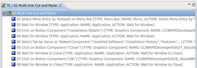

Steps: Create a test case with multiple steps. Number each step's Test Case Name #01-#NN to later help verify the step's ordering.
index.php/fa/15016/0/

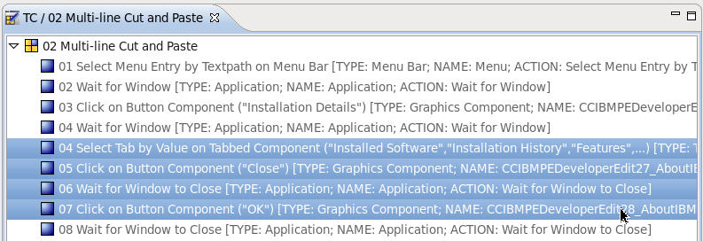

Select multiple lines #04-#07 and select cut.
RECOMMENDATION: The cut lines are not removed from the view and for improved usability I think they should be.
index.php/fa/15017/0/

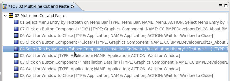

Select target line #02 and select paste.
ERROR: the cut lines are inserted in REVERSE order.
RECOMMENDATION: Also I has assume that paste would place the lines AFTER line #02 and not BEFORE it.
index.php/fa/15018/0/
