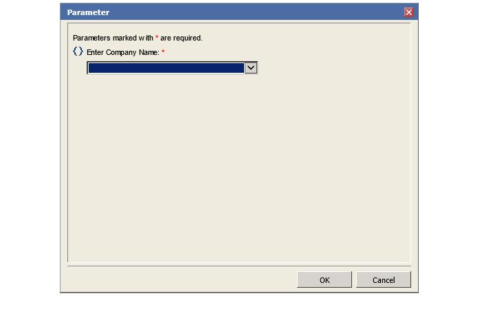

i want the parameter mandatory option to go away.
when i dont select any value from the list it should give all the values present for that report.
is there any way to disable the mandatory option?
please help...
its really very urgent...

You can set a default value to "All" and check the value in your beforeOpen of your dataSet and modify your query. Or, you can uncheck the isRequired box in your parameter editor and then do the same type of beforeOpen script. If you'd like a simple example, let me know your BIRT version.
[Updated on: Tue, 14 May 2013 23:13] by Moderator
Re: don't want Parameters to be mandatory [message #1058784 is a reply to message #1058776] Wed, 15 May 2013 01:26 Go to previous messageGo to next message
BIRT Report Designer Version is 4.2.2
alresdy tried unchecking isRequired box, but it does not work.
Re: don't want Parameters to be mandatory [message #1058948 is a reply to message #1058526] Wed, 15 May 2013 18:09 Go to previous message
Take a look at this report. I included both options. Look in the before open script of each table's dataSet.
