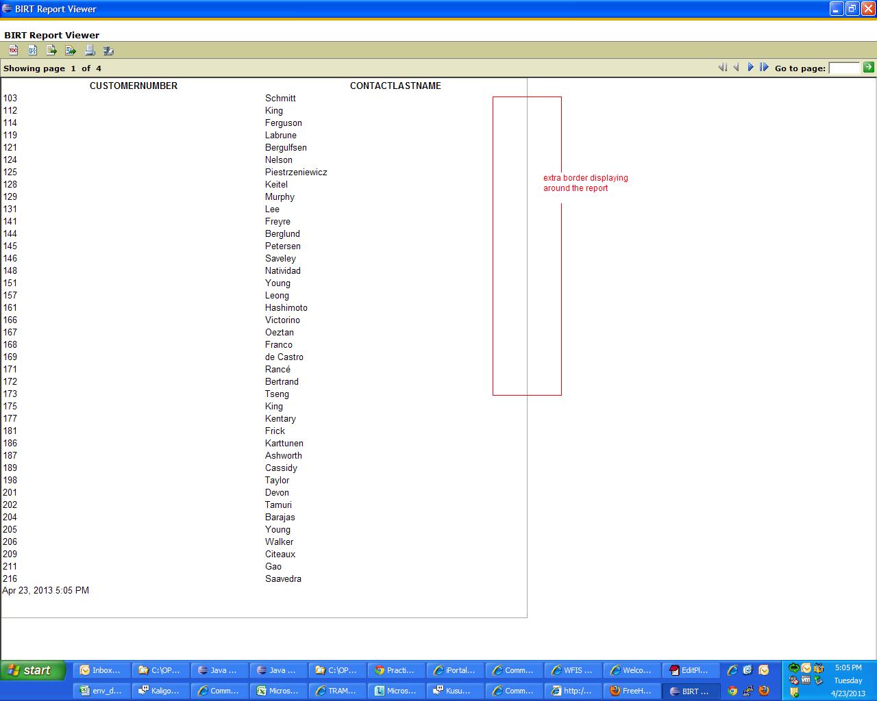

We are using birt 4.2.2 runtime and generated a report in HTML we have observed there is extra border line around the report.
Using birt viewer this bug can be reproduced.Please find the attached rptdesign and run with birt web viewer ,
Actual :
The report will be displayed with default border
Expected behaviour : The report needs to displayed without border.

Can you post a screenshot of the report with the border? I'm not getting it when I view your report from tomcat 6. Have you tried the frameborder tag?

PFA screenshot with border

It looks like your running the report from eclipse. How are you going to deploy the report? When I deployed it in Tomcat 6 there is no border.

The output I get from the JSP code above is different from what I see in the image you attached. The border you show is only an issue in Internet Explorer from what I've seen. Let me know if this is the case for you. The way I've gotten around this is to add a white border to the masterpage:

Yes the bordre is appearing only in Internet Explorer.We do not want border to be displayed in the reports generated using 3.7 and viewed through 4.2.2 version.
The option suggested above might only work for reports that will be generated from now on, but what about reports already generated using 3.7.
