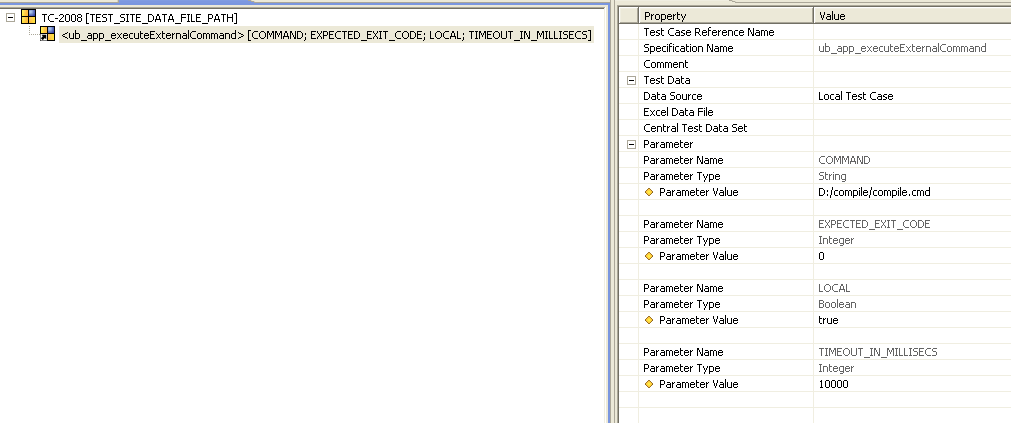

I would like to run a command file (.cmd) from within Jubula. The command file starts a shell and runs a shell script:
sh ./compileCBR2BvFiles.sh ../Testdata/includes/CBR2_4.0_core_include ../Testdata/includes/CBR2_BV_L2_3.0_include output
Double-clicking the command file from the explorer gives a successful result!
The problem is to start it from within Jubula. I have tried to use <ub_app_executeExternalCommand>, but without any luck. See attachment for parameter value details. When using this command I get exit code 127 and I haven't got a clue what this means.
Any ideas how to run the command file from within Jubula?

Messages: 376
Location: Braunschweig, Germany
I don't have the time to try this right now but my guess would be that you have to use DOS/Windows syntax to specify the script file, i.e. use either
d:\\compile\\compile.cmd
or
'd:\compile\compile.cmd'
(Note the single quotes)
- Achim

I have now tried both alternatives and neither of them works. Both give exit code 127.
Any other ideas?
Regards Richard

You can try to put whole command like parameter value in Jubula external command:
I'm executing some Powershell commands like this way, and it's work.
If you don't bother to use this huge code as command, then it can be solution.
