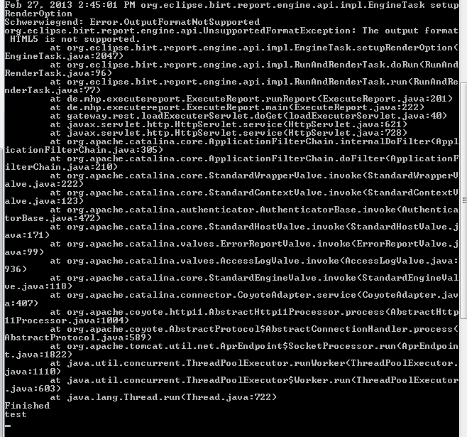

Now when I deploy my emitter on my tomcat I get following error:
If I don't rename the packages and use the html output I get the output of my emitter but In this case I can't use the default html emitter.
