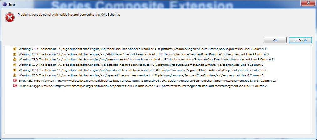

I'm working on the following example:
Adding a Chart Type To BIRT(devShare)
When I try to import the XML Schema I get following error:
index.php/fa/13045/0/
Samet
  • Attachment: EMF-Error.png
    (Size: 85.03KB, Downloaded 589 times)
Re: Adding a Chart Type To BIRT - Error while Importing XML Schema [message #1004274 is a reply to message #1003709] Tue, 22 January 2013 17:39 Go to previous messageGo to next message
You need to get the xsd files from the chart plugin. What I did was downloaded the birt source from github. Then I imported org.eclipse.birt.chart.engine as an existing project. After that you will be able to add segment.xsd without any errors.
