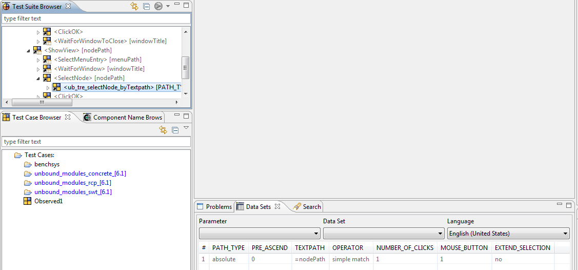

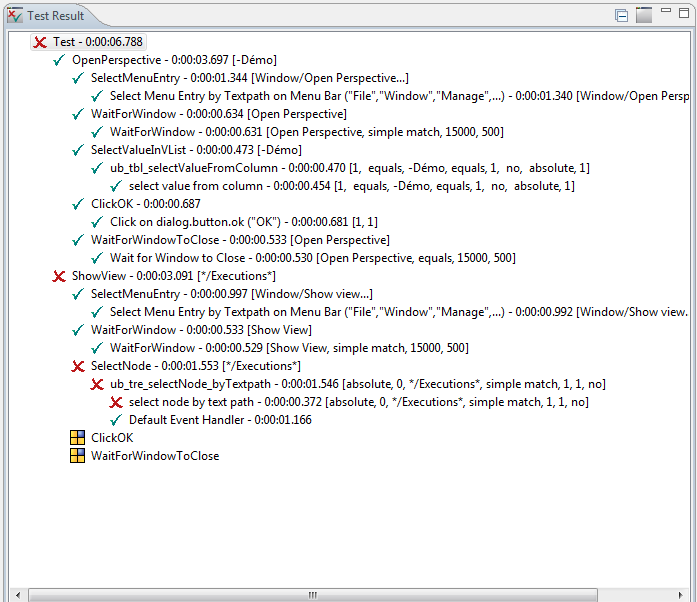

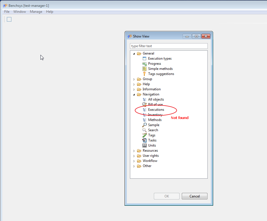

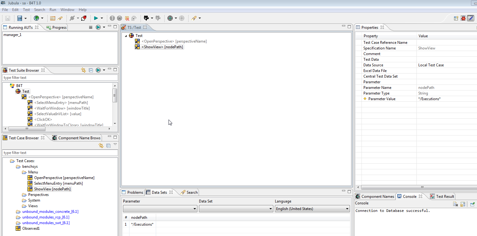

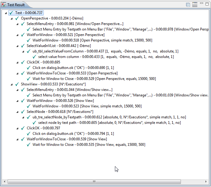

I was trying to (simple) match the node path 'Navigation/Executions' in a tree as you can see in
index.php/fa/13307/0/
If I use */Executions* as in
index.php/fa/13308/0/
it does not work
index.php/fa/13309/0/
index.php/fa/13310/0/
But with N*/Executions it does
index.php/fa/13311/0/
What's wrong with my test case?
Andre

Re: Tree node checking inconsistent [message #1007511 is a reply to message #1007499] Wed, 06 February 2013 09:17 Go to previous messageGo to next message
Andre Renard is currently offline Andre RenardFriend
Messages: 39

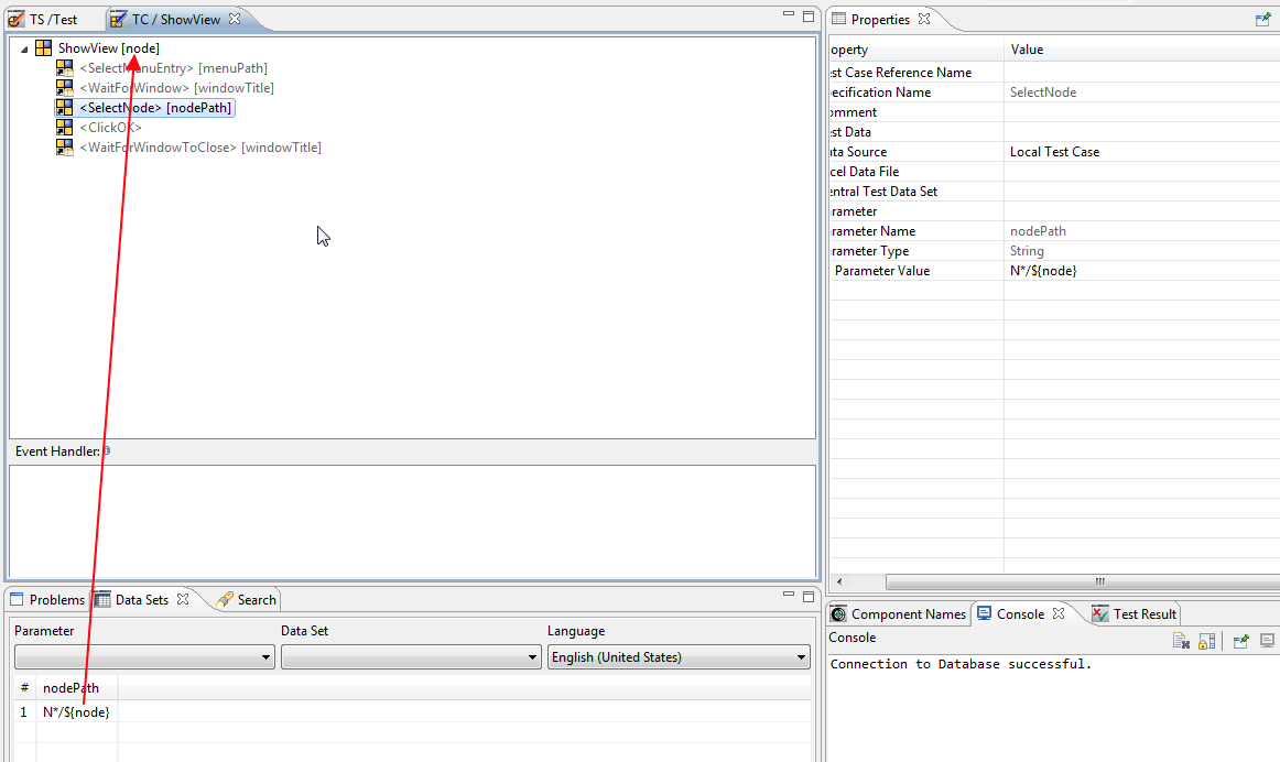

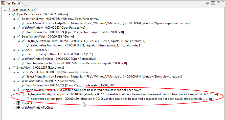

Also I don't understand what I am doing wrong here. Error message says that the variable should be saved. How do I do that? Do I forget something?
index.php/fa/13312/0/
index.php/fa/13313/0/
  • Attachment: Image 9.png
    (Size: 48.00KB, Downloaded 1049 times)
  • Attachment: Image 10.png
    (Size: 43.30KB, Downloaded 1021 times)
Re: Tree node checking inconsistent [message #1007529 is a reply to message #1007511] Wed, 06 February 2013 10:40 Go to previous messageGo to next message
Sylvain EVEILLARD is currently offline Sylvain EVEILLARDFriend
Messages: 556
= is for parameters, ${} for variables so =node should work here
Re: Tree node checking inconsistent [message #1007540 is a reply to message #1007529] Wed, 06 February 2013 11:10 Go to previous messageGo to next message
Messages: 39
Registered: February 2013
Location: Liege, Belgium
Indeed it does. Thanks.

I got the same results using matches.
N.*/Executions* works but not .*/Executions
Re: Tree node checking inconsistent [message #1007701 is a reply to message #1007544] Thu, 07 February 2013 08:10 Go to previous messageGo to next message
Alexandra Schladebeck is currently offline Alexandra SchladebeckFriend
Messages: 1613
Andre,
Ah, now I understand. Paths are analysed stepwise - that means that if you enter * for the first level, then the first item that matches this will be taken (in this case, General). Executions is then not found, and you get the error. N* works because the first thing that matches this path part is the "Navigation" item.
Best regards,
Alex
