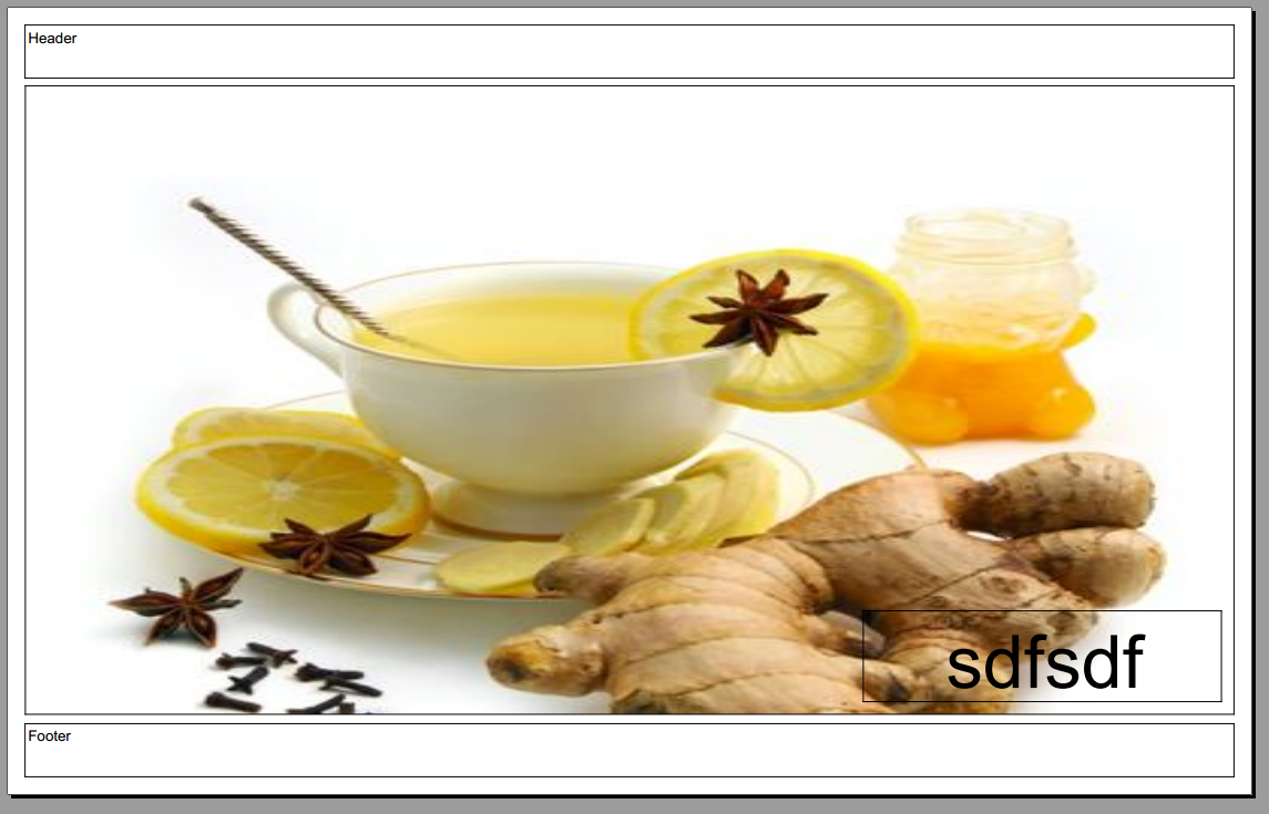

I have a table, each of its row contains an image (its size is as wide and as hight as the page except header and footer) and a grid.
I would like to move that grid up, so it will overlap the image like below
I do that by setting top margin to the grid -50mm. The problem is, it cant produce PDF report. The PDF is corrupted and there is stacktrace:

If I change the image height so both, the image and the grid are on one page, then it works, but the image is not as high as the page.
How can I do that? Thanks
