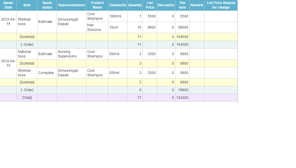

Complex table structure using Nebula [message #993962] Tue, 25 December 2012 21:18 Go to next message
I have a table with multiple rows which will be dynamic. In between these rows i will have summary row to count Sub Total Amount and Final row will be Summary row to populate Total Amount. Each row will contain Amount of particular Item.
For example
Category1 -Item1 -100 USD,
-Item2 -200 USD.
Subtoatal to Category 1 - 300 USD.
Category2 -Item1 -300 USD,
-Item2 -100 USD.
Subtoatal to Category 1 - 400 USD.
Now total Amount row will add subtotal amount of each category i.e 700 USD.
Is there any option to achieve this using Nebulla. Basically i am trying to replicate Webpage Table to SWT/Jface . Attached is the screenshot. Also please note that values in table will be populated from Database

Re: Complex table structure using Nebula [message #994909 is a reply to message #993962] Fri, 28 December 2012 11:03 Go to previous messageGo to next message
Hi Prashant,
I answered your question on the NatTable forum here: http://www.eclipse.org/forums/index.php/t/443734/

Re: Complex table structure using Nebula [message #994961 is a reply to message #993962] Fri, 28 December 2012 13:26 Go to previous messageGo to next message
Grid also support col and rowspan!

Re: Complex table structure using Nebula [message #1001668 is a reply to message #1000673] Thu, 17 January 2013 02:05 Go to previous messageGo to next message
Hi... Attached is the look n feel of Table i am looking for. I am trying to get this in Nat table but not able to achieve this.
  • Attachment: Table1.png
    (Size: 34.31KB, Downloaded 493 times)
Re: Complex table structure using Nebula [message #1001675 is a reply to message #1001668] Thu, 17 January 2013 02:20 Go to previous messageGo to next message
Why not? This should be an easy one. If it's only about styling, you need to override the styling configuration of the ColumnHeaderLayer and the body layer stack you are using.
Have a look here on how to configure styling http://eclipse.org/nattable/documentation.php?page=styling

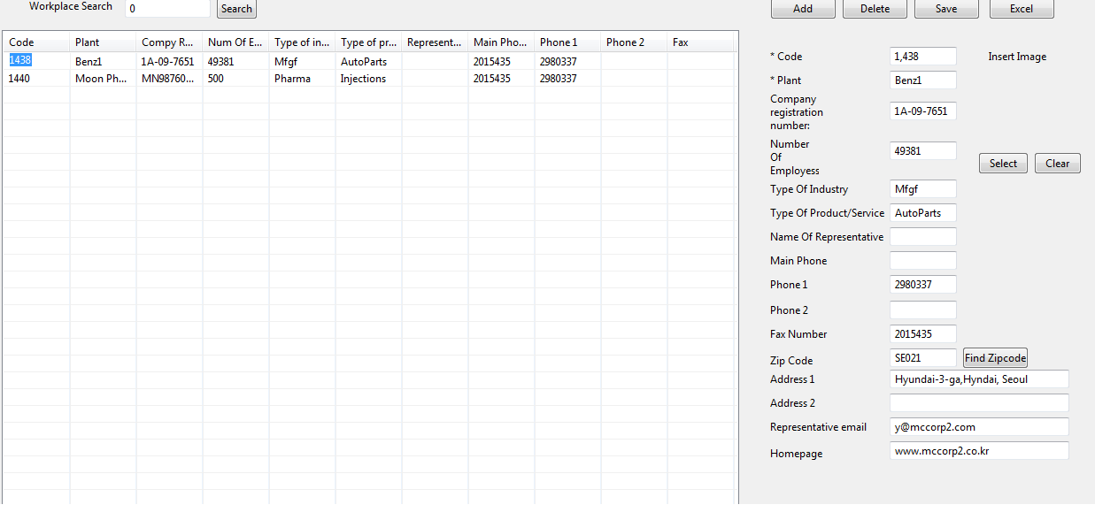

Re: Complex table structure using Nebula [message #1002126 is a reply to message #1002112] Thu, 17 January 2013 20:31 Go to previous messageGo to next message
Hi Dirk, I have attached sample application screenshot of SWT/JFACE which i am trying to achieve with Nattable as i said in above explaination
  • Attachment: Example.png
    (Size: 45.19KB, Downloaded 1023 times)
Re: Complex table structure using Nebula [message #1002219 is a reply to message #1002126] Fri, 18 January 2013 02:44 Go to previous messageGo to next message
Is there any proper code sample available?
There are a lot of code samples and examples out there. Have a look at the examples provided by us in the examples project (click the Try it button).
There are more examples linked here http://eclipse.org/nattable/documentation.php?page=articles ... while the articles are written in German, the corresponding examples are documented in code in English.
Will Nattable support JFace data binding?
No ... and yes. If you like to add databinding to the NatTable like you do it with a JFace table, then definitely no. This is because the main concepts differ to much. I talked about this on the EclipseCon Europe 2012. You can find a video showing my slides together with the voice record here http://www.youtube.com/watch?v=ws9TdGwZkKc ... hope my English isn't too bad to understand.
But looking at your example screenshot, what you need to do is use JFace databinding for mapping your form fields to your datamodel. And link your datamodel to your NatTable. The only thing you need to do as we didn't support that easily out of the box, is to attach some PropertyChangeListeners so the NatTable gets updated if you change a value in the back. If you use GlazedLists than there is some implementation, but you need to have a closer look. E.g. the BlinkLayer is a good start.
