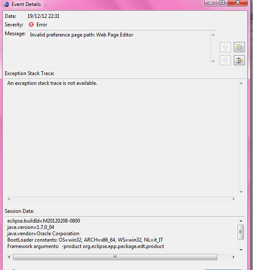

in the log i find the errore "Invalid preference page path: Web Page Editor"
see attached image ..
what do it means ??

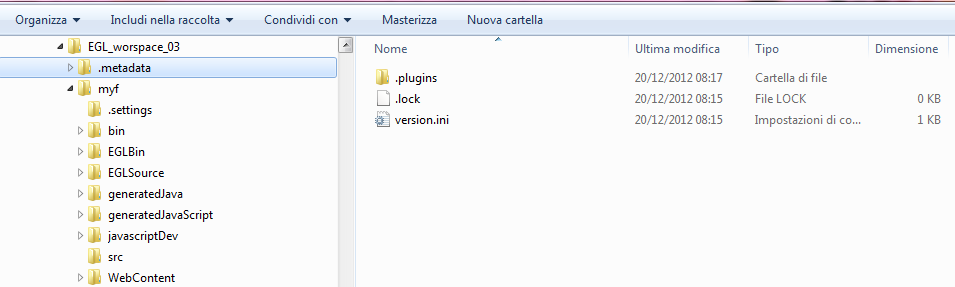

if i create a new workspace and then copy my sample in it i have the same problem ; I have tha sama problem also if i create a project from the template "Hello world
If you still have the problem in the new workspace, please attach the '.log' file under folder '%workspace%\.metadata' to here.
sorry but under '%workspace%\.metadata i don't see any .log file (see attached picture)
Thanks in advance for your help

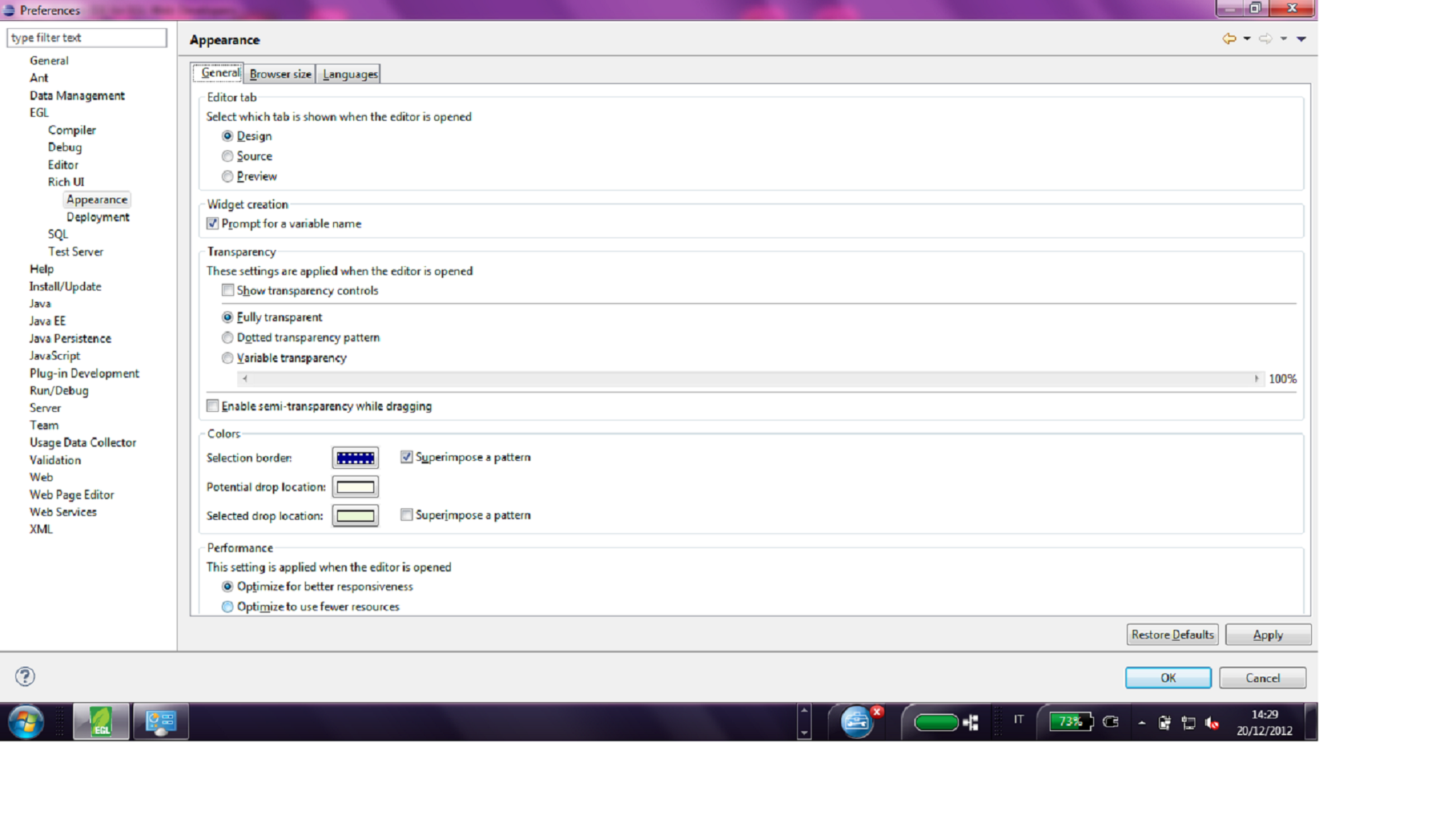

What's your JRE and IE version? Could you please check setting of 'Render engine for Rich UI editor' (Windows > Preference > EGL > Rich UI > Appearance)?

1- is regular that i don't have .log files under folder '%workspace%\.metadata' ?att
2- attached screenshot of "Windows > Preference > EGL > Rich UI > Appearance"
3- i have jre 1.4.2_13 and ie 9.0.8112
thanks
