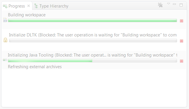

I just upgraded my Android SDK for a Juno SR1 instance running on a very large workspace, and upon starting Eclipse is non-responsive for a long time. I can't interact with the workbench (Windows says "Not responding...") but the progress view shows this:
index.php/fa/12741/0/
It looks like it's doing a workspace build before the JDT tooling is fully initialized. The workspace has about 50 dependent projects, most of which are Java and/or Android projects.
Could this be some deadlock? Would Java tooling have to be fully initialized before the workspace can even build?
Eclipse eventually recovered, but it was stuck in this state for at least 10 minutes.
I can't reliably reproduce this, but is there anything else I could try to shed more light on this problem?
Thanks!

On 19.12.2012 01:24, Mirko Raner wrote:
> Hi there,
Make some stack traces and report the bug against Android tooling.
Dani
