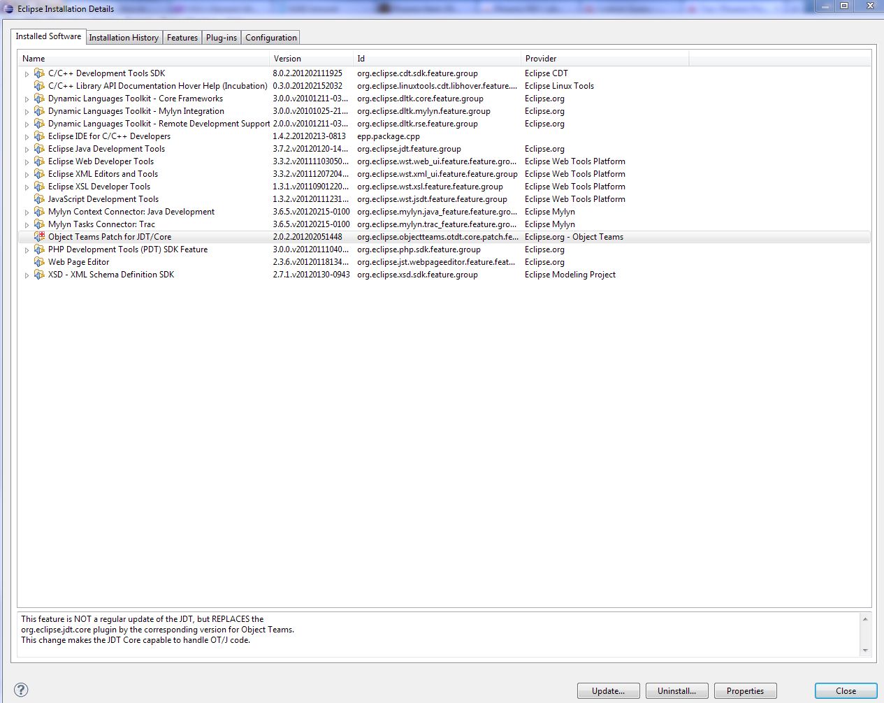

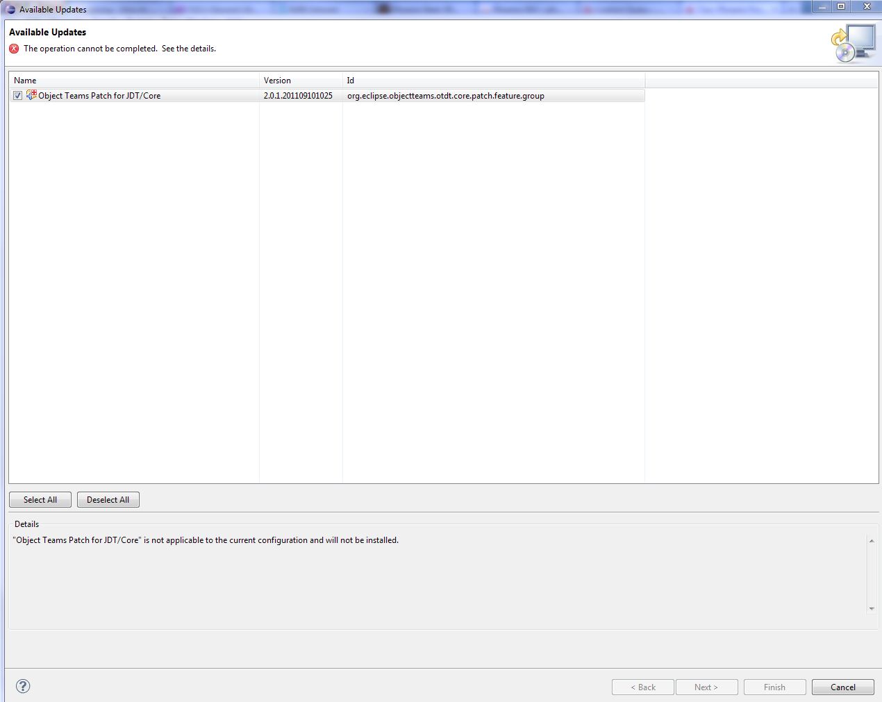

I don't know what specific updates available for my Eclipse, and just try to be up-to-date. It only indicates the operation cannot be completed due to "Object Teams Patch for JDT/Core" issue, not showing any other update available. The screenshot is attached. I also attached my installed plugins screenshot for reference.

Wow, so p2 is proposing to "upgrade" the OT patch feature from 2.0.2 to 2.0.1???? What makes the tool think this is an update? I have no idea.
Two suggestions:
- (repeated from above): "if the Object Teams feature got installed by accident the above mentioned "Installation Details" dialog allows you to Uninstall any installed feature."
- (new): if you want to explore more about the current (broken) state, you should probably show me your list of software sites from where updates are fetched.

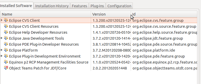

After fixing that and adding the indigo update site into Eclipse Indigo (looks indeed inconsistent), I could do several rounds of updates with no problem. I think the second update suggested to install the Object Teams patch, and it installed without a problem.
Wait, as I'm speaking, on trying the forth round or so of updating, I can see the problem.
At this point I have the following situation:
  1. installed is Eclipse Java Development Tools 3.7.2.v20120120-1414-.....
  2. installed is Object Teams Patch for JDT/Core 2.0.1.201109101025
  3. proposed for update is Object Teams Patch for JDT/Core 2.0.2.201202051448
  4. error is: "Object Teams Patch for JDT/Core" is not applicable to the current configuration and will not be installed.
Observations:
  • (1) and (2) should not be compatible (although installing this worked OK).
  • (1) and (3) should be compatible
  • While displaying the error message, the Detail message is no longer shown, which normally reads:
    This feature is NOT a regular update of the JDT, but REPLACES the
    org.eclipse.jdt.core plugin by the corresponding version for Object Teams.
    This change makes the JDT Core capable to handle OT/J code.
Eclipse p2 has several known bugs that amount to the fact, that normally patch features cannot be installed into a shared install for which the user has no write permission. Partly I'm surprised to see it work in this situation at all.
I happen to know that Pascal Rapicault is right now re-writing part of p2 in order to improve the situation for shared installes (including better error messages, migration strategies etc.) - this will go into Eclipse 4.3 (Kepler).
I will be a while before these fixes show up in Ubuntu.
Finally I tried to install the full Object Teams Development Tooling. Again installing seemed to work alright, only when I wanted to start working in the Object Teams perspective did I find that neither this nor the Java perspective were available. I.e., something claimed that installation was successful, where in fact it had broken the install.
