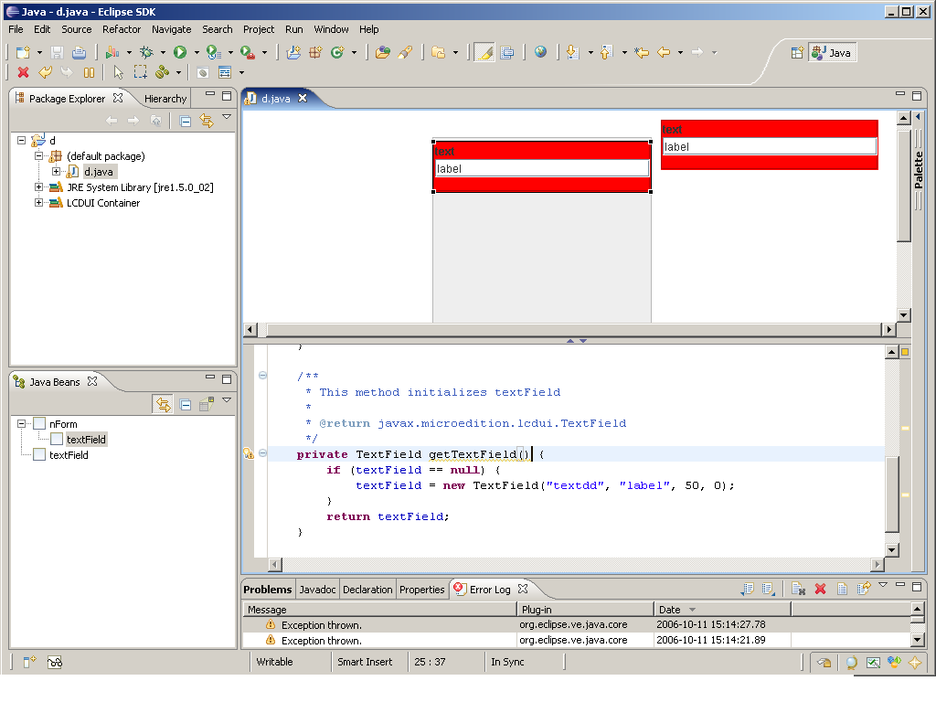

I have a custom widget named TextField(extends JPanel and contains
JTextField and JLabel). When I drop this widget from the palette, I need to
get something like this
textField = new TextField("text", "label", 50, 0);
I was able to generate this code using allocation mechanism.
My TextField.xmi file is shown below.
<lcdui:TextField xmi:id="TextField_1">
<allocation
xsi:type="org.eclipse.jem.internal.instantiation:ParseTreeAllocation ">
<expression
xsi:type=" org.eclipse.jem.internal.instantiation:PTClassInstanceCreati on "
type="javax.microedition.lcdui.TextField">
<arguments
xsi:type="org.eclipse.jem.internal.instantiation:PTStringLiteral "
literalValue="text"/>
<arguments
literalValue="label"/>
<arguments
xsi:type="org.eclipse.jem.internal.instantiation:PTNumberLiteral "
token="50"/>
<arguments
token="0"/>
</expression>
</allocation>
</lcdui:TextField>
I have a decoder, decoderhelper, containmenthandler and graphical
edit part associated with my customwidget.
My GraphicalEditPart is not doing much, decoderhelper is used to prevent
generation of setBounds() for customwidget.
ContainmentHandler is used to control adding of custom widget to other
containers.
But when I drop my custom widget the below mentioned exception is
thrown by VE. Custom widget is getting added to the parent(even though
exception
is thrown by VE) but when I try to change the values inside the constructor
call - textField = new TextField("text", "label", 50, 0); - another custom
widget is created and added to the Editor.
Please see the attachment.
Someone please tell me what is going wrong. Any help would be good
for me.
