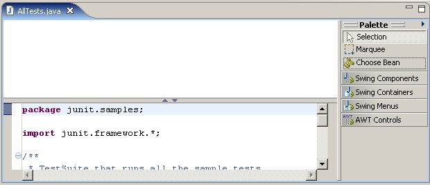

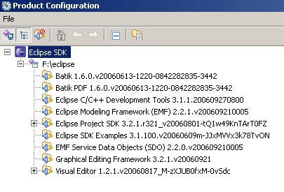

I have VE 1.2 and what I believe to be all of the latest versions of GEF,
EMF, Eclipse Build SDK etc. but I don't see SWT components, containers,
menus, or controls when attempting to use the VE...
Any ideas?
  • Attachment: VEInstall.jpg
    (Size: 43.82KB, Downloaded 318 times)

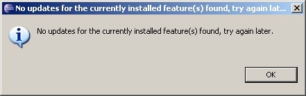

The error log indicates this might be a problem with emf core...but all
updates to installed features are up to date...
(see attached image)

Originally posted by: richkulp.us.NO_SPAM.ibm.com
Did you try using the new visual class wizard to create a SWT/JFACE
visual class?
Rich Kulp

Thanks for the suggestion Rich... but I still get no SWT/JFace options in
the VE...
I checked the error log on bringing up Eclipse and found this... I presume
that this means that there is an EMF related problem...
I have no idea where to begin correcting the problem since I am new to
Eclipse...

Re: Installed VE doesn't do SWT/JFace [message #614717 is a reply to message #132163] Wed, 18 October 2006 12:06 Go to previous message
visual class?
Rich Kulp
