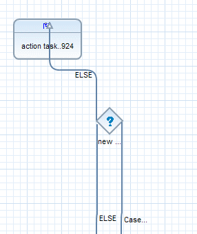

As you can see in the figure above, connections starting from left of a diamond shape are starting from slightly different locations. However, I have a BoxRelativeAnchor attached to the left ( relative width=0 and height = 0.5) corner of diamond node i.e. all the connections should start from a same location. I also have a invisible rectangle shape attached to the BoxRelativeAnchor as its refrence graphics algorithm, does this playing any trick? How start/end of connections can be made more smooth?
Suggestions will be highly appreciated?
Best Regards
Surya

not sure, but this might depend on the width of the lines you use (both for
the diamond shape and the connection). There might be some rounding issues
invlved here while mapping the line thickness onto diagram points...
There are some open Bugzillas for this (378341, 383532). Maybe you can try
to play around with different line thicknesses.
Michael
