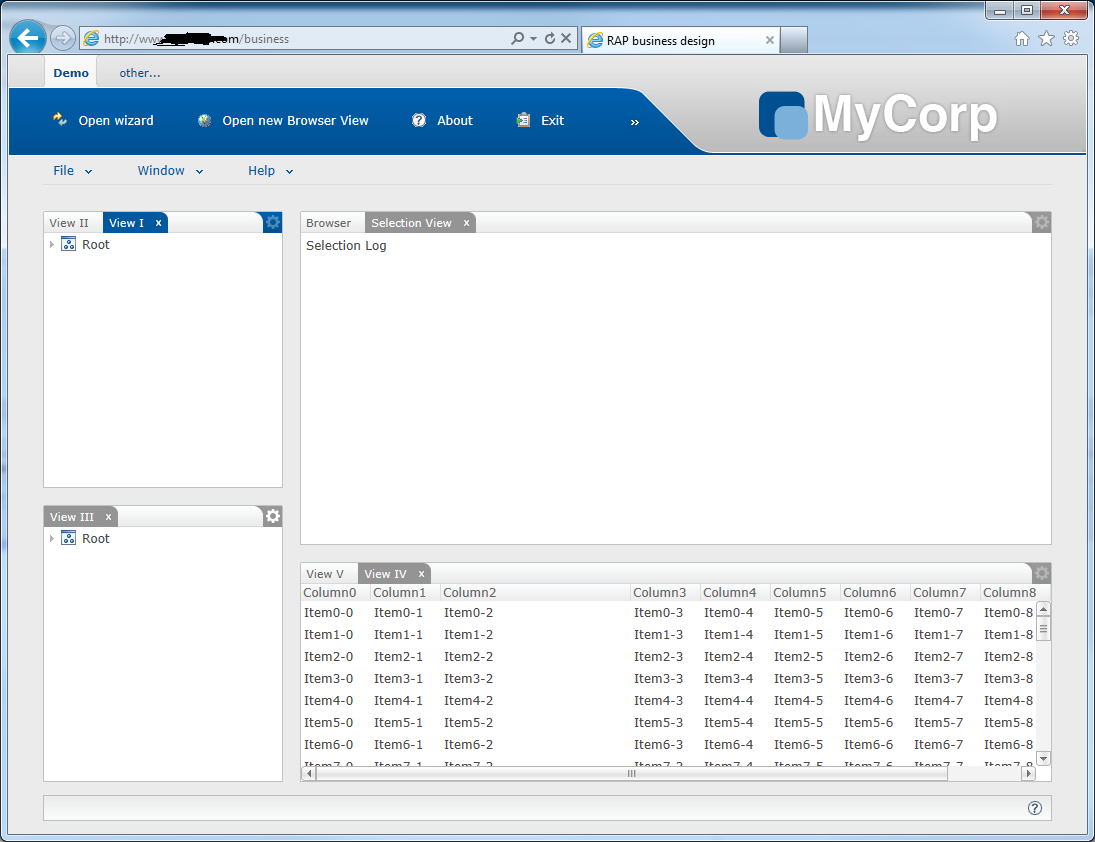

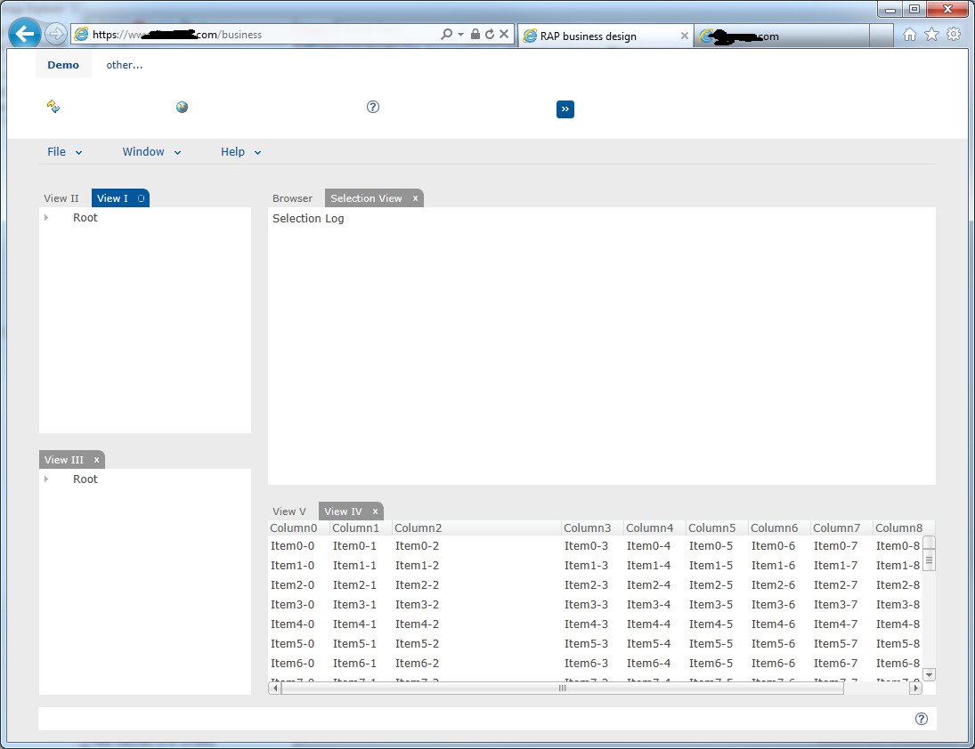

I have to come back to this topic as it is a big blocker for our project.
We have now successfully running our server with a GlobalSign SSL certificate.
I started the RAP demo directly from Eclipse running on the server. The problem occures together with the business or fancy design, so I used the workbench demo.
I'm using RAP 1.5.0.20120612 and the following params:
-Dorg.eclipse.equinox.http.jetty.https.enabled=true
-Dorg.eclipse.equinox.http.jetty.https.port=443
-Dorg.eclipse.equinox.http.jetty.ssl.keystore=C:/Server/www.xxx.com.jks
-Dorg.eclipse.equinox.http.jetty.ssl.keypassword=xxx
-Dorg.eclipse.equinox.http.jetty.ssl.password=xxx
On Firefox/Chrome/Safari everthing works with http and https, on IE7,8,9 it works just with https, but with https it is quite ugly. See attached screenshots.
Here with http on IE9 everything is good:
index.php/fa/11598/0/
Here with https on IE9:
index.php/fa/11597/0/
I have no idea what to do now, so any help is really appreciated.

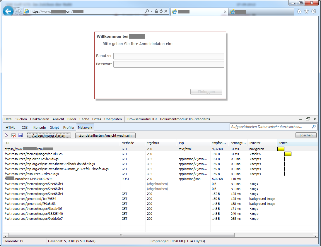

Hi.
Let's try this:
* Open IE
* Press F12 to bring up the debug-console
* Switch to the "Network" tab
* Click "start recording"
* Start the RAP application, wait for it to load completely
* Click "stop recording"
* Make screenshots of the resulting table and of the various tabs in the
detail view of one of the failed requests for an image.
Perhaps we can lern something from this.
Greetings,
Tim

I found out that it always works in the local browsers of my servers (HostEurope Virtual Server L and Amazon EC2 Maschine) and not on connections over the Internet. The F12 console in IE shows "Abgebrochen" which means "Aborted" for the relevant images. So I guess it is kind of a timeout.
The IE is not waiting long enough. I did not found any timeout settings I can tweak. Also we are talking about something under 1ms, which is not what a timeout covers typically.
I attached the main view of the Network tab when connection to the login view of our own app. The gray RAP background and an icon are missing and you see exactly 2 aborted image requests. The detailed tab are completly empty for that two, so I didn't attached them.
This is a really weird problem for me and again any help is highly appreciated.
~Ingo

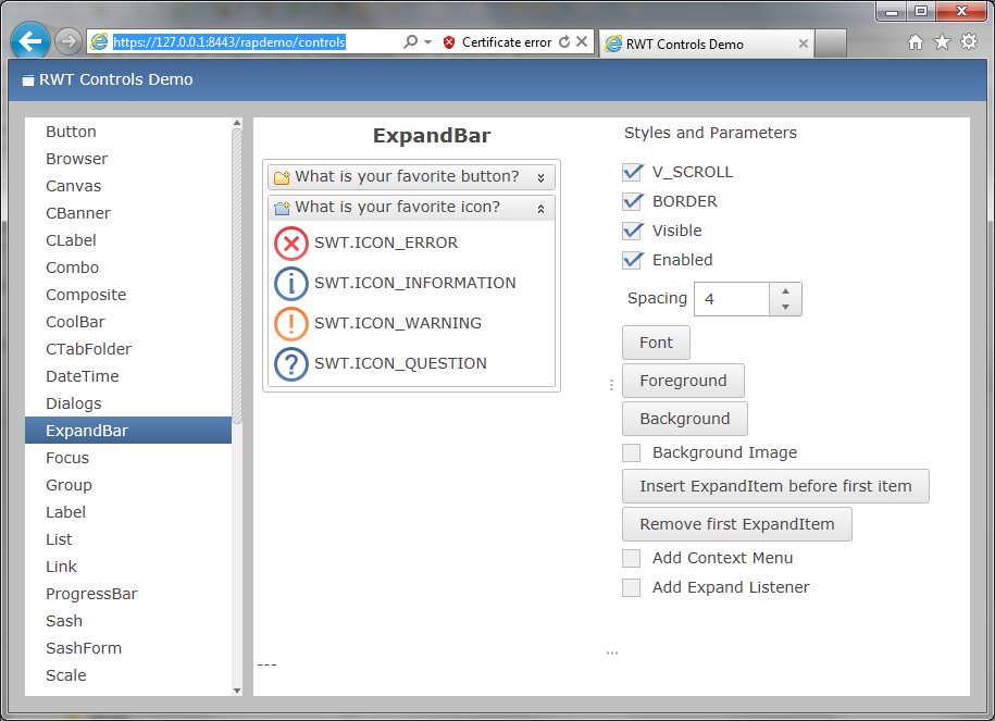

once again... just tested Controls Demo over SSL in IE9 (Windows 7 with
QuickTime installed) and all images are in place. I didn't test it over
Internet.
I really have no idea what could be the problem.
Best,
Ivan
Internet.
Best,
Ivan
Internet.
Best,
Ivan

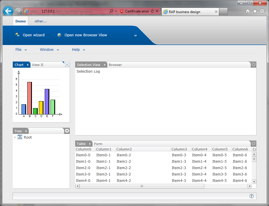

could you please test the workbench demo with the layout design demo "business" or "fancy"?
I was not clear at this point, sorry for that, but for me the error comes when using the designs. The control demo is ok for me too.
I forgot to mention that, sorry.
It would be very interesting to know if you have the error then also.
~Ingo

Workbench demo is fine too...

The big problem is that we are unable to reproduce it. Your screenshot
gives us some infos, but i can't really derive any clues from it where
to look for the problem. Perhaps you can give some more info:
* What RAP version are you running exactly?
* Could you try applying the patch attached to this bug:
https://bugs.eclipse.org/bugs/show_bug.cgi?id=362921
For that you need to import the org.eclipse.rap.rwt bundle and use it
in your launch config.
* Did you try another certificate? Just to see if it's related to the issue.

* Do the failed requests always look like in your screenshot? (Multiple
tries for the same image, <img> as initiator?)

  4. The screenshots look always like the one I posted earlier.
