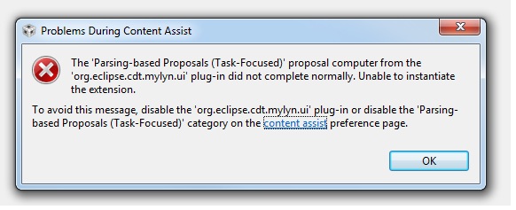

I installed Eclipse alongside with TI's Code Composer Studio and so far it worked ok. But just as of recently I am having serious trouble being supposedly related to some configuration conflict or plugin incompatibility.
The symptom is that every time I close an editor window tab, I run into an error popup dialogue claiming that some mylyn content assist module has acted up.
It proposes a cure for the problem in disabling the content assist features or disabling the plugin altogether, yet none of these options are either possible or successful.
For a more experienced user this might be an easy task to fix; so I hope in order to become one, someone might be able to at least give me a hint as to where to start getting rid of this misbehaviour.
Thanks a lot in advance for anything!
p.s. please see a screenshot of the error in the attachment

Re: "Problem During Content Assist" error pops up constantly [message #899582 is a reply to message #896392] Wed, 01 August 2012 10:07 Go to previous messageGo to next message
Not sure I can help you with a proper solution, but the same annoying thing has happened to my Eclipse installation.
I am running Eclipse 3.6.2 on Ubuntu 10.04, and following an upgrade to Mylyn 3.8.1 I did yesterday, the problems started. So I guess it has something to do with the latest Mylyn?
Did your problem also start after an Mylyn update?
Now I am stuck with this problem, as I cannot get Eclipse to revert to an earlier configuration or uninstall the Mylyn updates, so I will probably just reinstall everything as this is very annoying.
Jannich

Re: "Problem During Content Assist" error pops up constantly [message #900456 is a reply to message #896392] Tue, 07 August 2012 03:46 Go to previous messageGo to next message
Now filed as bug #386724.
/Jannich
Re: "Problem During Content Assist" error pops up constantly [message #900495 is a reply to message #896392] Tue, 07 August 2012 05:47 Go to previous messageGo to next message
Milhouse van Houten <forums-noreply@xxxxxxxx>
The problem is now tracked on this bug:
386724: "Problem During Content Assist" error pops up constantly
https://bugs.eclipse.org/bugs/show_bug.cgi?id=386724
To fix it, please install the latest version of the "Mylyn Bridge: C/C++
Development" feature from the Mylyn release update site at
http://download.eclipse.org/mylyn/releases/3.8.
You need version 5.4.0 or later to ensure compatibility with Mylyn 3.8. The
current version of the bridge is 5.4.1.v20120725-0100.
Steffen
