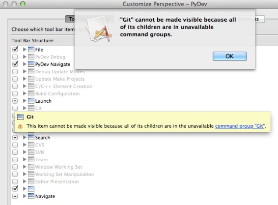

As I think I've also mentioned, my git repos are in a separate dir (~/git) than my other (svn, etc) Eclipse projects (~/Documents/workspace).
Regarding your suggestion to "customize corresp persp and enable the Git...", I right-click on a Persp in the top tab of the gui and click on "Customize", but I seem to get an error "Git cannot be made visible because all its children are in unavailable command groups" (see attached screenshot)

Re: transitioning from svn to git [message #884783 is a reply to message #884768] Mon, 11 June 2012 16:22 Go to previous messageGo to next message
You have to import the projects from the git repository into your workspace to really work with your files. To do that, you right-click on the repository in the Git repositories view and select "Import projects". If you did that, you'll see your projects in the Project explorer, and then you also should see markers, when you change a file. (Also note: The projects are not physically imported in the Eclipse workspace directory, only linked into your Eclipse workspace).
The update site http://download.eclipse.org/egit/updates-nightly is only accessible via Eclipse Install manager. The 404 in the browser is correct.

Re: transitioning from svn to git [message #885220 is a reply to message #884865] Tue, 12 June 2012 12:20 Go to previous messageGo to next message
You should un-install at least EGit Project Set Support and the GitHub stuff before upgrading. You might want un-install the two 'Source' plugins as well, you don't need those anyway.
re: Customize, use Window -> Customize Perspective, then enable the Git command-group,
