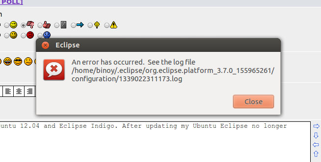

I use Ubuntu 12.04 and Eclipse Indigo. After updating my Ubuntu Eclipse no longer works.
An error has occurred.  See the log file
/home/binoy/.eclipse/org.eclipse.platform_3.7.0_155965261/configuration/1339022492430.log
Here's the content of /home/binoy/.eclipse/org.eclipse.platform_3.7.0_155965261/configuration/1339022492430.log :
$ cat /home/binoy/.eclipse/org.eclipse.platform_3.7.0_155965261/configuration/1339022492430.log
!SESSION Thu Jun 07 04:11:32 IST 2012 ------------------------------------------
!ENTRY org.eclipse.equinox.launcher 4 0 2012-06-07 04:11:32.441
!MESSAGE Exception launching the Eclipse Platform:
!STACK
java.lang.InternalError: internal error: SHA-1 not available.
	at sun.security.provider.SecureRandom.init(SecureRandom.java:105)
	at sun.security.provider.SecureRandom.<init>(SecureRandom.java:84)
	at java.security.SecureRandom.getDefaultPRNG(SecureRandom.java:186)
	at java.security.SecureRandom.<init>(SecureRandom.java:150)
	at java.io.File$LazyInitialization.<clinit>(File.java:1681)
	at java.io.File.generateFile(File.java:1694)
	at java.io.File.createTempFile(File.java:1803)
	at org.eclipse.equinox.launcher.Main.canWrite(Main.java:1290)
	at org.eclipse.equinox.launcher.Main.checkConfigurationLocation(Main.java:691)
	at org.eclipse.equinox.launcher.Main.basicRun(Main.java:568)
	at org.eclipse.equinox.launcher.Main.run(Main.java:1410)
What's going on? How can I fix this?
