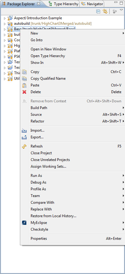

We use Eclipse Indigo Service Release 2 and installed AJDT version 2.1.3 from the Eclipse marketplace. Now we want to convert an existing Eclipse Java project to an AspectJ project. What we are missing is the context menu item for conversion. Any idea what went wrong or how to get this menu item?

That's pretty odd. The "configure" menu item should be available by default. It is provided by the IDE, not AJDT.
I'd first check your error log. Window -> Show view -> Error log. Are there any relevant errors? Feel free to attach the entire log file.
From your screenshot, it looks like you have other aspectj projects in your workspace, so the installation itself seems to be working. Also, it looks like you are using myeclipse. Is this right? What version>

The version of myeclipse is: 10.1.0.me201203170059
I also tried installing the AJDT into a new eclipse installation without any other extensions. Inside the installation it works as described. So it might be that there is a conflict with one of the extensions we use (Jalopy, Checkstyle, Mylyn, Atlassion JIRA Connector, Subclipse, MyEclipse)
