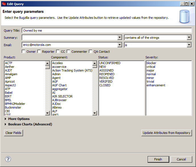

Wanted to create a "My Issues" query on Eclipse Bugzilla. I filled out the query form using the wizard as shown. the only fields I filled out were the query title and my email address, along with the qualifier "is". (See Screenshot)
When I would go to synchronize the query, it would run without end. I don't have that many total bugs in the system (~71), so it shouldn't run forever. But it would just sit at 0% forever. It wasn't until I went back and selected the checkboxes and made further refinements on the form that I started getting results.
I know setting up development tools isn't the easiest thing in the world, but many of the players in the lifecycle aren't developers. I was operating on instinct, not poring over a manual. I know how to operate the web-based bugzilla, but I haven't spent any time with the Mylyn interface. I think if this situation is going to cause the server to spin indefinitely, the UX should have some front-end logic to guide me toward creating a correct query.

thanks for your insightful input. This type of feedback is very helpful to
streamline workflows in the tooling and improve the UI experience.
The particular issue that you raised was addressed in the 3.7 release. The
query dialog now shows a message in the header when an email address is
entered but none of the checkboxes are selected. More details are on this
bug:
368295: all results returned when querying for user but not specifying
the fields to search
https://bugs.eclipse.org/bugs/show_bug.cgi?id=368295
Please feel free to open tasks in our Bugzilla at any time if you notice
shortcomings in the UI design.
Steffen
