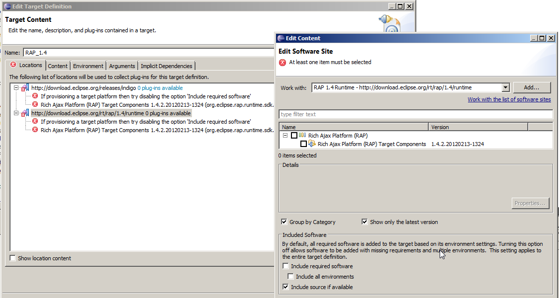

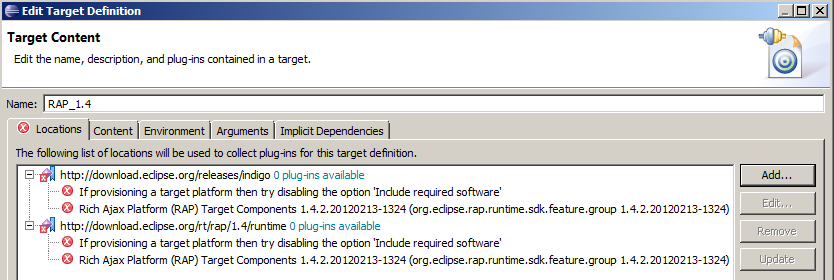

Re: A tutorial about Single Sourcing with RAP [message #852738 is a reply to message #847590] Sun, 22 April 2012 05:02 Go to previous messageGo to next message
Hi Ralf,
thank you for you comment!
When I try to edit the target platform I get several errors (see attached image).
index.php/fa/8031/0/
The stange thing is that also with these errors the platform is working well.
Do you have any suggestion?
Vincenzo

Re: A tutorial about Single Sourcing with RAP [message #852755 is a reply to message #852738] Sun, 22 April 2012 05:22 Go to previous messageGo to next message
Hi Vincenzo,
you get a screen like this when one of the repositories is temporarily
not responding or does not have the selected versions available anymore.
This error usually goes away when you select one of the repositories and
press "Update".
Regards, Ralf

Re: A tutorial about Single Sourcing with RAP [message #852769 is a reply to message #852748] Sun, 22 April 2012 05:41 Go to previous messageGo to next message
Hi Arnaud,
the suggestion (disabling "Include required software") has been indeed used when that Location has been originally added.
With this curren situation, if I press Edit, I see that the feature seems not installed and I can reinstall it, disabling "Include required software". But after installation, if I come back to editing the target platform, the errors are there again.
Vincenzo
Re: A tutorial about Single Sourcing with RAP [message #852777 is a reply to message #852755] Sun, 22 April 2012 05:50 Go to previous messageGo to next message
Hi Ralf,
pressing "Update" has no effect (I was at least expect some sort of background jobs for contacting the sites, with some little delay in the response; instead seems just like the Update button has no action/command associated!).
The Locations are working well; infact if I press "Edit" I have to reinstall that feature, see below
index.php/fa/8032/0/
The re-installation is working well and the errors diappear.
But when I go back to editing the platform the errors are there again!
Vincenzo
Re: A tutorial about Single Sourcing with RAP [message #852994 is a reply to message #852777] Sun, 22 April 2012 11:19 Go to previous messageGo to next message
Hi Vincenzo,
I'm sorry that it didn't help. I only know that the target editor
sometimes shows errors all over even when only a single repo or IU has a
problem. This really makes it hard to understand what causes the
trouble. Anyway, this is a PDE issue and we cannot do anything about it.
I'd try to create a new target and add the same content, just to see if
there's a problem with one of the repositories. I can recommend working
with target definition files (New -> Target Definition) because these
can be edited in an editor without blocking the entire UI.
Regards, Ralf
Ralf Sternberg
Twitter: @EclipseRAP
Re: A tutorial about Single Sourcing with RAP [message #853752 is a reply to message #852994] Mon, 23 April 2012 05:52 Go to previous message
Hi Ralf,
thank you again.
I tried to make a new RAP workspace and start all over again: now it works correctly!
Regarding your suggestion on using a Target Platform Definition I will certainly follow it, although maybe not just for the tutorial in our site, for now...
Thank you
Vincenzo
