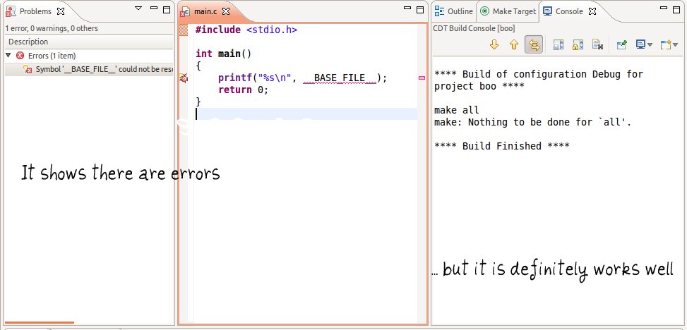

Hi everybody!
I have installed Eclipse Indigo for C/C++ Linux developers on Ubuntu 10.04 x86.
When I use common predefined macro '__BASE_FILE__' Eclipse says
Symbol '__BASE_FILE__' could not be resolved
but compilation is OK. I have to use it so often in my code and Eclipse fills my screen with red lines and bug icons Smile
It is simple to reproduce:
#include <stdio.h>
int main()
	printf("%s\n", __BASE_FILE__);
	return 0;
How can I fix this?
Probably the screenshot may explain it better Smile
index.php/fa/7852/0/

Re: __BASE_FILE__ [message #841315 is a reply to message #840948] Wed, 11 April 2012 02:39 Go to previous messageGo to next message
That is an error message from the static code analyzer CODAN. It cannot find the symbol __BASE_FILE__ in its index. That's a gcc internal define (therefore compilation works) but I think it is not defined in any header. So you must add this symbol manually to Project Properties->C/C++ General->Paths and Symbols: Symbols (C in your case).
Re: __BASE_FILE__ [message #841508 is a reply to message #841315] Wed, 11 April 2012 08:05 Go to previous messageGo to next message
Axel Mueller wrote on Wed, 11 April 2012 02:39
Yes, captain. But.. other predefined macros such as __FILE__ or __LINE__ are not marked as errors. If I'll add this macro manually then I don't get expected result (file's name).
I can only do one to reduce the Eclipse to silence.
#ifndef __BASE_FILE__
#define __BASE_FILE__ ""
#endif
Looks like it is bug of the analyzer.
Re: __BASE_FILE__ [message #841833 is a reply to message #841508] Wed, 11 April 2012 15:27 Go to previous messageGo to next message
Yes, these macros are known to the CDT indexer. You could open a bugzilla request (or submit a patch Smile ) so the indexer does recognize __BASE_FILE__ , too.
In the mean time you can use this workaround
#ifdef __CDT_PARSER__   // symbol is internally defined by the Eclipse CDT parser)
#endif
