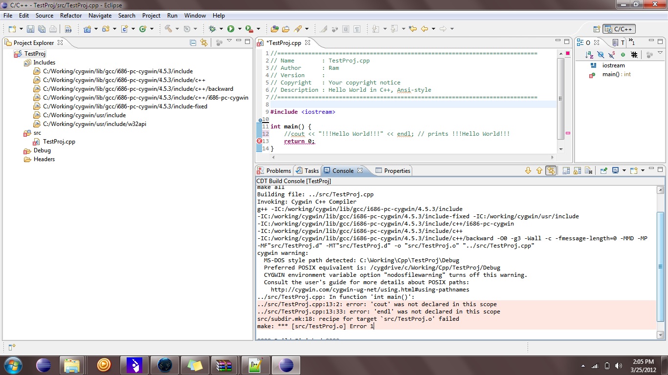

I have installed cygwin and Eclipse and trying to build my first cpp project but it is becoming a nightmare setting up and building it. The problem is,
a) Cannot recognize the libraries and function like cin and cout
b) After you comment out this line the compliers still shows the previous error
I have show a detailed screenshot of this error
Please help me solve this stale error issue
I have also done a Index -> Rebuild which did not help
Ram

First, the TestProj.cpp file has not been saved. The '*' next to the
file name in the editor tab indicates this. The compiler will only work
with the saved version of the file.
Second, cout and endl are in the std namespace. You need to either add
a using namespace std line of prefix cout and endl with std::
(std::cout, std::endl).
