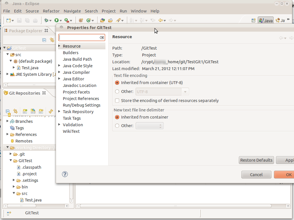

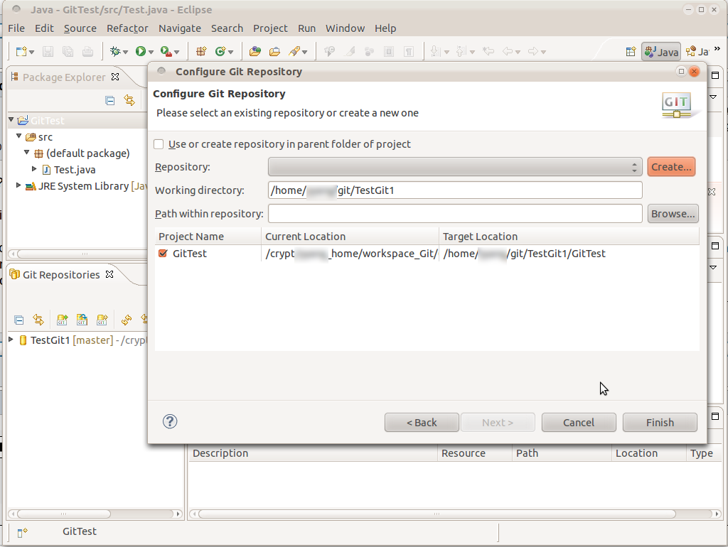

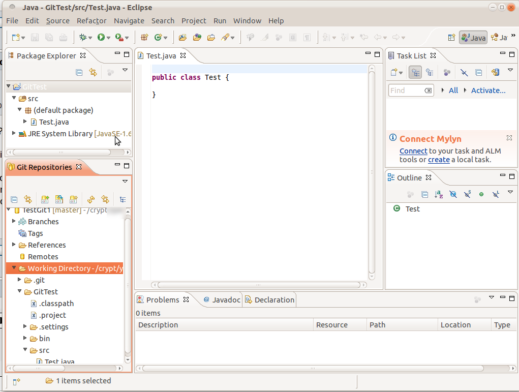

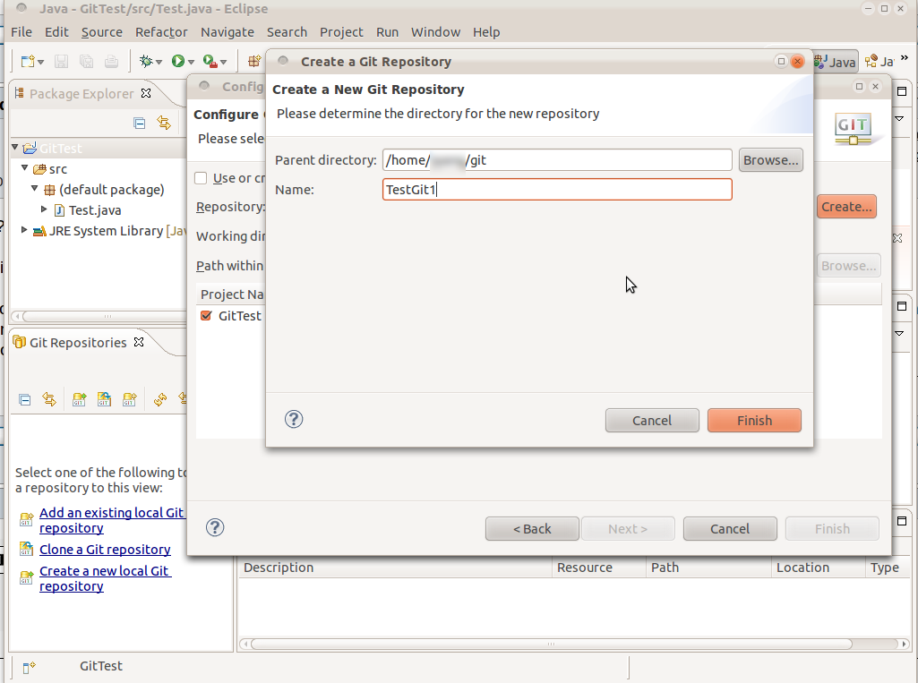

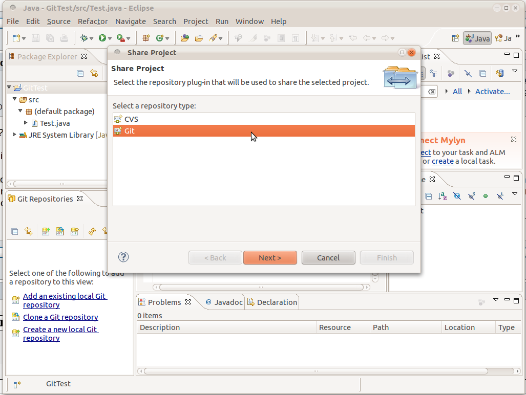

Thanks.
I shared the project using right click menu---> "Team"---> "share project", then choose the git option.
I do see this project in the repositories view
I also tried deleting the project and re-importing it from git, but it seems to be the same.
(see Git5.png)
