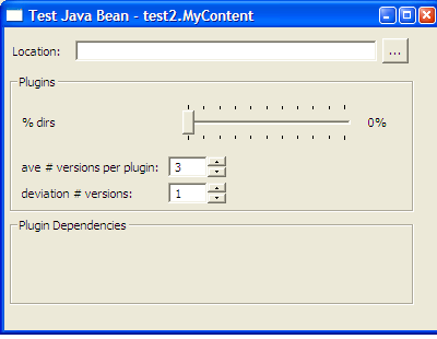

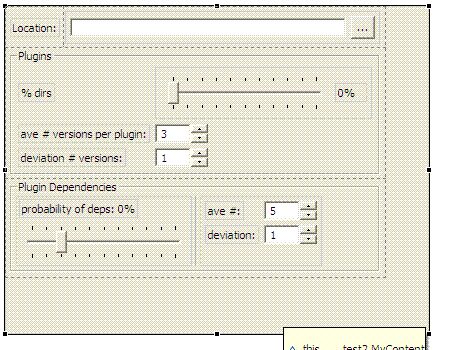

Experimenting with a composite using VE, I was changing layout managers on
some sub-containers. Now, while the VE editor window shows everything, if I
run the class as a Java Bean, part of the Composite isn't visible. Any idea
why? When run as a bean, the group labeled plugin dependencies appears
empty:
Joel

Originally posted by: richkulp.us.NO_SPAM.ibm.com
I don't know why it shows for you because when I bring it up in the VE
it looks the same as your runtime picture.
The reason it looks that way is because "group" has no layout manager
defined on it, so all of the children controls have no position and size.
Rich Kulp
