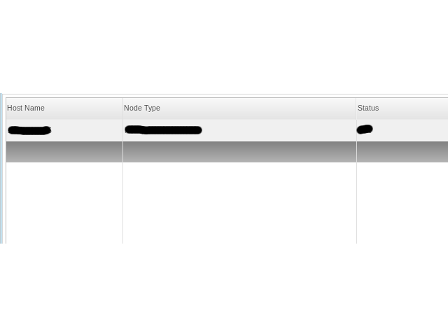

This is my first topic, so please bear with me Very Happy
Using the TableViewer, I select a row, it highlights, and then we click an icon to delete the item from our database. I then set the TableViewer input to an updated list from the database. Row is deleted, and viewer displays the correct list, but the row of the deleted item remains highlighted, and cannot be deselected.
Below is code. Code of interest is createViewer() where we add the listener for when the delete icon is clicked, and then method deleteNode() is called.
I have tried deleting and deselecting the selected item from viewer.getTable(). I'm still not sure the underlying cause of why the row remains highlighted after I reset the viewer input. Attached is the table and the highlighted row after deletion.

The AbstractTableViewer tries to preserve the selection even if you set a new input. Although I do not understand why the viewer finds an item which is equal to the deleted item. Anyway: I would try to remove the selection before setting the new input.
Furthermore it seems to me like you pass the same model into the viewer after removal of the node. In that case a viewer.refresh() should be sufficient to reflect the model change.
So all together I would guess that the following should do it:
if (nodeDeleted)
   // display message
   viewer.setSelection(StructuredSelection.EMPTY)
else
   // display message
// viewer.setInput(newInput);
viewer.refresh();
Re: Row remains highlighted after delete item in TableViewer [message #821900 is a reply to message #821841] Thu, 15 March 2012 20:02 Go to previous messageGo to next message
Hi Thorsten,
I am not passing the same model. I am calling NodeModelProvider.getNodes() which gets a new list of elements from a DB. A viewer.refresh() will not reflect the deleted node.
I tried the proposed solution, but that did not work. I also taught that clearing the selection before delete would unhighlight the row. Could the fact that a modal dialog is open at the time of attempting to remove the selection? I dont think that should matter. I even tried viewer.getTable().deselect on selected indeces, but still no success.
Re: Row remains highlighted after delete item in TableViewer [message #821903 is a reply to message #821841] Thu, 15 March 2012 20:02 Go to previous messageGo to next message
Hi Thorsten,
Re: Row remains highlighted after delete item in TableViewer [message #822093 is a reply to message #821903] Fri, 16 March 2012 02:56 Go to previous messageGo to next message
Uh. Can't say. I have much more experience on RCP platform. One important thing about viewers that I have learned is that the refresh is asynchron. If all this fails I would try to remove the selection after all pending UI refreshes and stuff. So maybe you want to give an async exec a try?
viewer.getControl().getDisplay().asycExec(new Runnable() {
   public void run()
      viewer.setSelection(StructuredSelection.EMPTY);
And just to play with: have you tried to select something different rather than clearing the selection? Maybe select the first node or so. Just to check if selection works at all.

Re: Row remains highlighted after delete item in TableViewer [message #822428 is a reply to message #822153] Fri, 16 March 2012 12:03 Go to previous messageGo to next message
Ok, I have this working, but am not clear as to why it works, and what the problem is. showMessage is just a mesage dialog saying the node had been deleted. Below is the code snippet that works:
if (nodeDeleted) {
    showMessage(Messages.get().MessageDialog_ConfirmDeleteNode_title,
        NLS.bind(Messages.get().MessageDialog_ConfirmDeleteNode_message,
        selectedNode.getNodeAddress()));
    viewer.setInput(nodeModelProvider.getNodesFromDB());
So when user click delete on the confirm message dialog, and delete is successful in the backend, the selection is cleared, but the item is still visible in the viewer in the background because I have not reset the input. The message dialog appears confirming deletion, and then the viewer input is reset, and the viewer is updated, and selections are all cleared as expected.
Ideally, I want to clear the selection and update the viewer before showing the message dialog confirming deletion, so that the user doesnt still see his selection in the background. But I try the following, and I get the same weird behavior where the row is deleted but stays highlighted.
if (nodeDeleted) {
So I'm confused why it would work with the message dialog in between the setSelection and the setInput, and not when they are together. I also tried without the message dialog and the same error occurs. Seem buggy to me, unless I'm doing something wrong.

Re: Row remains highlighted after delete item in TableViewer [message #822440 is a reply to message #822428] Fri, 16 March 2012 12:20 Go to previous messageGo to next message
Hi George,
as I mentioned before, there was a bug in the client-side Table (Tree)
implementation. See:
366272: [Tree] Full selection artifacts remain shown upon collapse of
tree node
https://bugs.eclipse.org/bugs/show_bug.cgi?id=366272
I think that this is the same issue. It has been fixed in 1.5M5. Which
RAP version are you using? Could you try your application with RAP 1.5M5
or latest nightly?
Best,
Ivan
> if (nodeDeleted) {
> if (nodeDeleted) {
Ivan Furnadjiev
Twitter: @EclipseRAP
