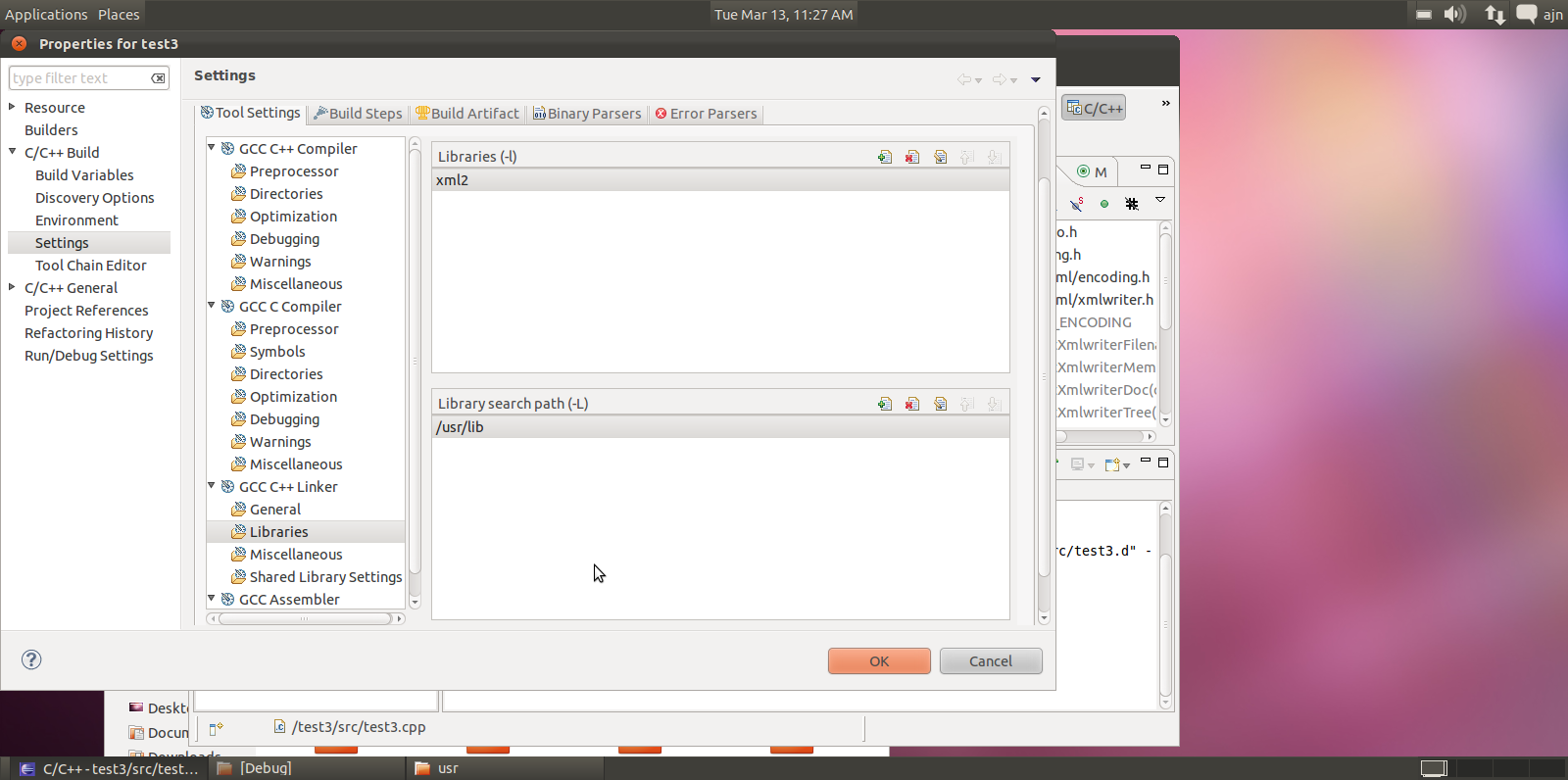

Re: libxml2 [message #819795 is a reply to message #819726] Tue, 13 March 2012 06:36 Go to previous message
Thanks a lot Axel. The problem is now resolved.
Exactly as you said
In GCC C++ Linker window
I had to add both
Libraries
(i)
xml2
Libraries search path
/usr/lib
Thanks again
