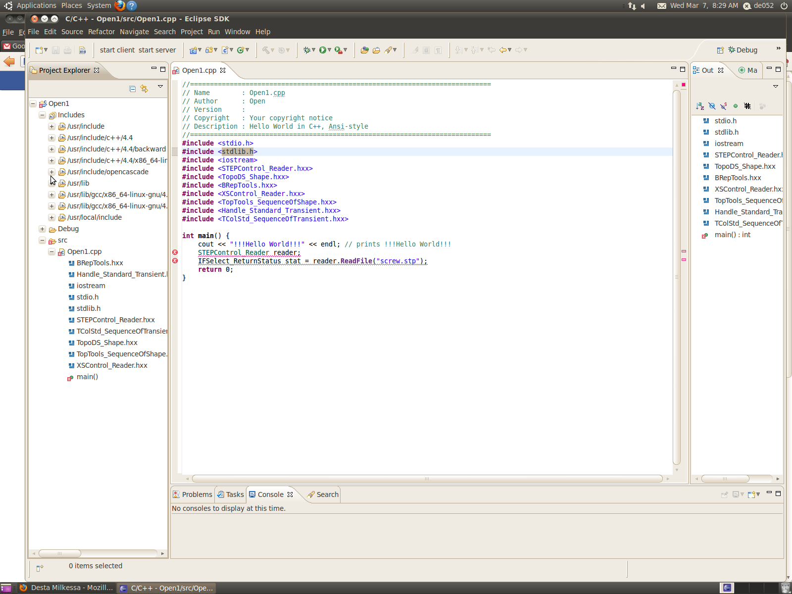

Re: Eclipse C/C++ and OpenCASCADE Libraries problem [message #815078 is a reply to message #814749] Wed, 07 March 2012 02:45 Go to previous messageGo to next message
Dear David,
Thank you for reply, it seems i added all libraries, here i enclosed the snapshoot. It seems Eclipse understand libraries, but couldn't run the main program! I am very new to Eclipse, and is there something special for Eclipse!

Re: Eclipse C/C++ and OpenCASCADE Libraries problem [message #815722 is a reply to message #815078] Wed, 07 March 2012 20:06 Go to previous messageGo to next message
On 03/07/2012 01:45 AM, game milky wrote:
> Dear David,
> Any information helps in this regard, if u have any tutor on this issue!
You appear to have added the library paths as include paths. You need
to use the Libraries/Library Paths tabs on the Paths and Symbols
property page for the project to specify libraries.
