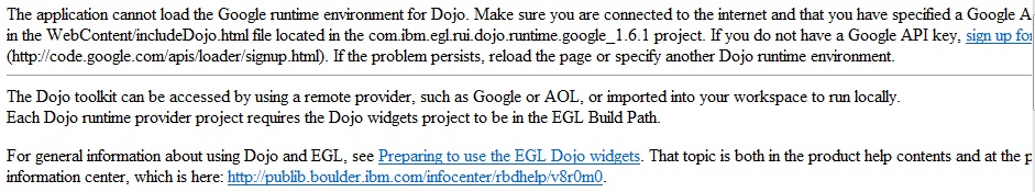

I am getting an error while i am trying to preview my handler. The error is "application cannot load google runtime environment", i have tried verifying my net connection and also the path Webcontent includeDojo.Html and i do not see any difference. I have attached the error for your reference. Please help me with your comments. Thanks

Hi Karthik,
2 options to resolve your problem,
1) Request a Google API key, and modify config/includeDojo.html as stated in the screen-shot you attached.
2) Import the Dojo local project, and change the EGL project reference to the local Dojo project (Right click your EDT project > Properties > EGL Build Path > Projects tab > uncheck the remote dojo project reference, and add the local dojo project reference.
To import the dojo local project, you can start the EGL project creation wizard. Choose either 'client' or 'client with services' template in the 1st page of wizard. In the 2nd page, choose the '0.7.0 (Dojo 1.6.1)' for the 'Dojo Widget' - the default is dojo remote project.

Thanks , i got them fixed using option 2.

Great to see the 2nd option works for you.
In our current plan, we're going to fix this problem without letting user to apply the Google API key. You can refer to https://bugs.eclipse.org/bugs/show_bug.cgi?id=363959 for more detail. It's expected to be included in 0.8.
