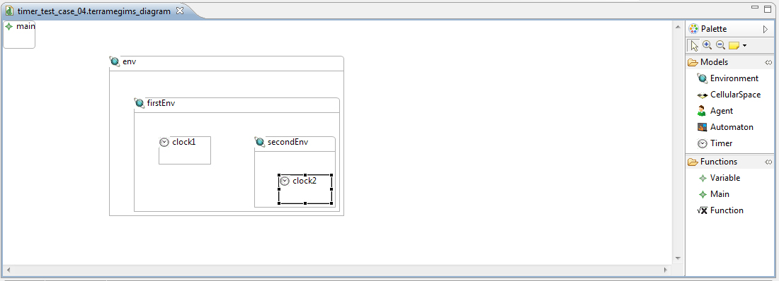

Helly guys, i'm using swtbot for my tests. I have a grafical aplication (GEF/GMF) in eclipse named TerraME GIMS and i don't know to test the element with compartment.
Take a look in the picture below, should look this way. So, situation is: How can i put two element of container type (firstEnv and secondEnv) inside other element of the same type (env)? Like in the picture below. The name of compartment is: EnvironmentCompartment.

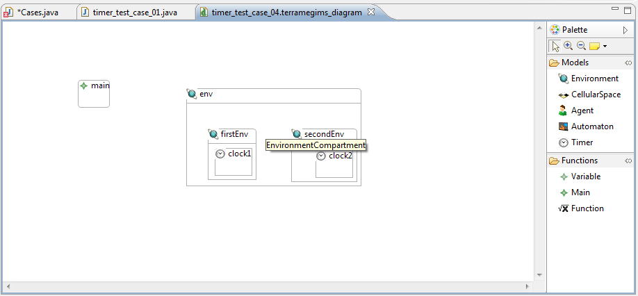

But don't work, looks like in the picture below and it's wrong. Later of i put the object "first" inside the object "env", all the objects i try put in env go inside the object first or the last object of container type put in it.
