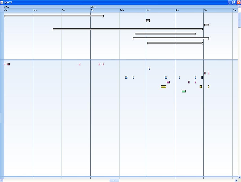

I work on an implementation of Nebula Gantt.
I've already created the Diagramm and imported Sections, Events and EventGroups and Scopes.
I've attached a picture of my Gantt Diagram.
As you can see in the section is too much free-space, caused by the calculation of the Nebula Gantt API.
Here is the function from
GanttSection.class
for ganttSection height-calculation:
int getEventsHeight(final ISettings settings) {
        if (_ganttEvents.size() == 0) {
            return settings.getMinimumSectionHeight();
        int height = settings.getEventsTopSpacer();
        for (int i = 0; i < _ganttEvents.size(); i++) {
            final IGanttChartItem event = (IGanttChartItem) _ganttEvents.get(i);
            if (event.isAutomaticRowHeight()) {
                height += settings.getEventHeight();
            else {
                height += event.getFixedRowHeight();
            if (i != _ganttEvents.size() - 1) {
                height += settings.getEventSpacer();
        height += settings.getEventsBottomSpacer();
        if (height < settings.getMinimumSectionHeight()) {
            height = settings.getMinimumSectionHeight();
        return height;
It adds for every event (24 Events at all) more height, but I just need the groupEvents (in this case: 7 GroupEvents)
calculated = 24 * 12px (eventheight) + 26 * 12px (eventspace) = 600px
i need = 7*12 + 9*12 = 192px
I've tried to override the function, but it's private.
What can I do ?
greets.
  • Attachment: Unbenannt.JPG
    (Size: 53.16KB, Downloaded 487 times)
[Updated on: Wed, 18 January 2012 07:35] by Moderator
Re: Change Section height of Gantt Diagram [message #787392 is a reply to message #780516] Tue, 31 January 2012 09:34 Go to previous messageGo to next message
Hi Bobo,
Please open a bug against technology.nebula for gantt. Please provide a patch if you can.

Re: Change Section height of Gantt Diagram [message #827386 is a reply to message #787392] Fri, 23 March 2012 04:59 Go to previous messageGo to next message
There is another way:
Set for every event a fixed row height:
eventOne.setFixedRowHeight(0);
if every event hast a fixed row hight you only have to write your own settings to overwrite the eventspacer:
public class MySettings extends AbstractSettings {
public int getEventSpacer()
return 0;
and at last put your settings in the constructor of the Chart.
GanttChart ganttChart = new GanttChart(shell, SWT.NONE, new MySettings());
And then you've a fixed section hight.
Me Name
Re: Change Section height of Gantt Diagram [message #830161 is a reply to message #827386] Tue, 27 March 2012 05:22 Go to previous message
the correct way is to give the ganttsection the ganttgroup and the size will be calculatet right.
                groupOne.addEvent(eventTwo);
		groupOne.addEvent(eventThree);
		gs.addGanttEvent(groupOne);
