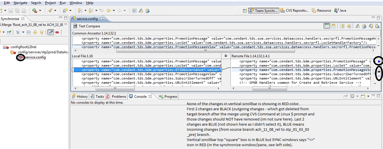

Did the same thing in Eclipse... manually to see how CVS merge is removing the lines in "stp_01_03_03_pre" branch for file "service.config"
steps:
a. checked out the module "config" from "stp_01_03_03_pre" branch
b. Did, Team+Merge, provide start+end tag as "Root..." and "ACH_...BUILD01" (im not
writing the full values here.
c. Did the merge with preview only.
d. In Eclipse Sync window, I'm seeing that file "service.config" is showing in RED
color icon "<>" (which means, this file has some conflicts and it has to be
manually resolved). Now, NOTE: when I ran CVS co -j -j.. command above and
committed the merged data, it was successful (without me doing anything).
e. Double clicked the file, it opened the file in Eclipse Text compare window
(Please see Attached and look for circles showing COLOR issues).
First of all, I'm just WONDERING... WHY ECLIPSE is NOT showing the "RED" color
conflict changes in the file (as usually seen in the vertical scrollbar).
Secondly, Sync window shows file has a conflict (due to RED color <> icon next to
it), but in Text compare window, the "[]" box just on the vertical scrollbar is
NOT filled with RED color (showing somewhere in the file, there is a code
conflict). It should show that little sqaure box in RED, IF Sync window is
showing RED "<>" icon infront of "service.config" file.
Text compare window shows body of a file - changes either in:
-- BLACK (outgoing change/workspace addition/removal),
-- BLUE (Incoming change/repository addition/removal) or in
-- RED color (Conflict change/addition/removal).
Apart from this, just on the vertical scrollbar (right side file area), vertical
scrollbar has a little square box "[]" filled in either "RED", "BLUE" or "GREEN".
-- BLUE saying code changes exists, manually / automatically resolve.
-- RED saying code conflict exists, manually resolve / auto complete all right
hand side (remote) changes to left (local).
-- GREEN saying - merges / changes are complete.
Any ideas!!!! what Eclipse is missing.
