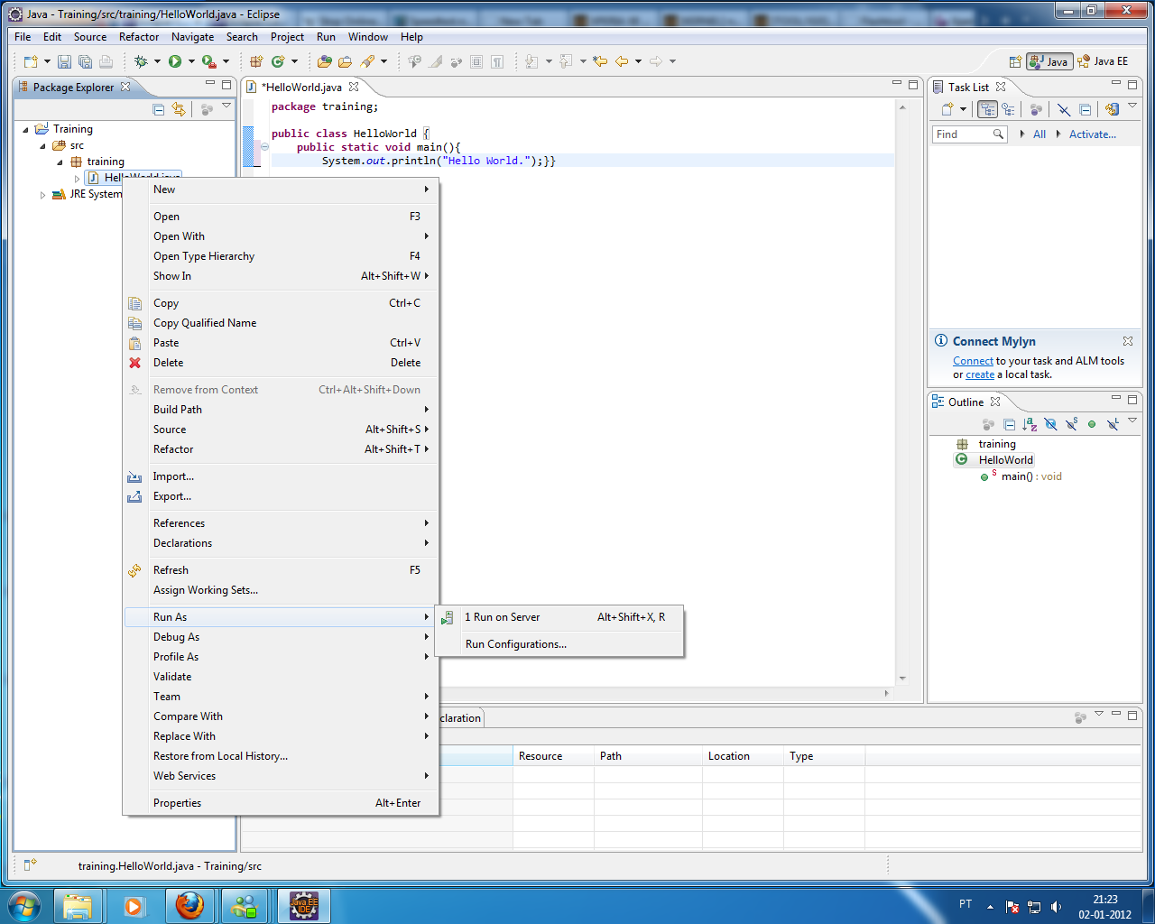

I've encountered something that is *really* bugging me. The problem is that every time I try to run a .class file, I click run, but then, Eclipse tries to run something that isn't selected, or that doesn't even exist!
I've posted a picture, showing what I mean. In the picture I got my helloWorld.java file selected. I clicked to run it. But for some reason, Eclipse wants to run the whole project. And I really don't know how to change that. I really need some help here.
index.php/fa/6608/0/

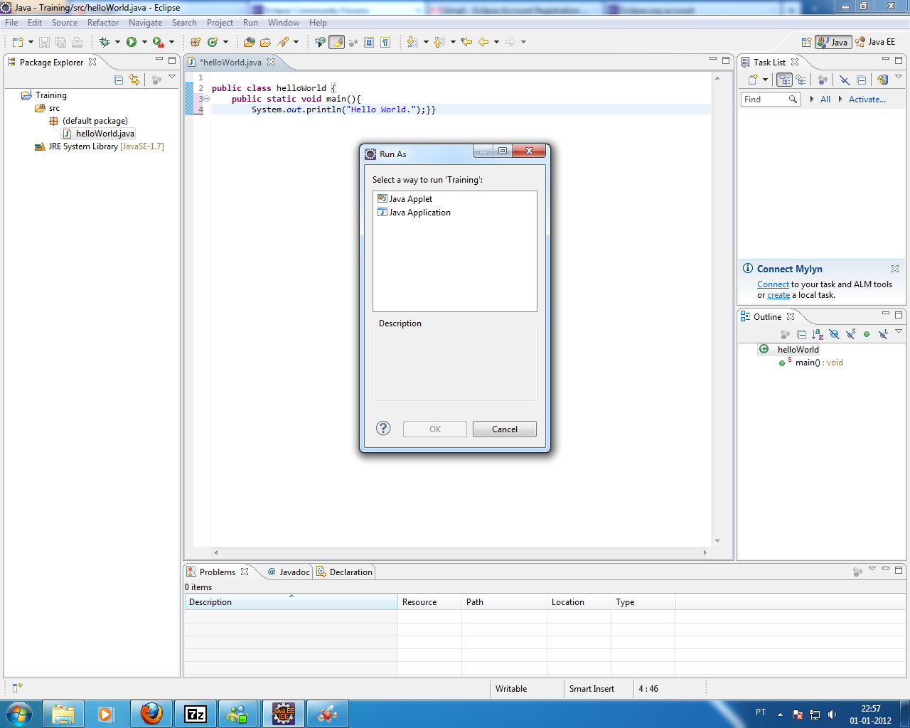

I've tried what you suggested, but that option doesn't seem to exist...
This next screenshot shows what I mean:
index.php/fa/6609/0/
Also, I tried looking at the "Run Configurations", didn't really understand how it worked.
Also, I've applied the tip you gave me. I was using lowercase class names because I had an odd memory of Eclipse telling that uppercase class names are not advised. But apparently, it's the other way around. Embarrassed

The class that you have selected is not a runnable class. Your main
method has to take a string array.
Re: Using Run [message #773946 is a reply to message #773921] Mon, 02 January 2012 18:53 Go to previous messageGo to next message
You sir, made my day.
I am following a set of tutorials, and on the tutorial it has as argument for the main method "String args[]". I was wondering what it was for... and I didn't write it. Now I know what it is for... Embarrassed
Thanks, once again.
