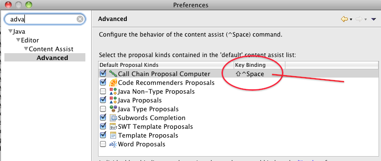

Despite that it works. It's unclear to me how to make this shortcut appear in "Preferences >> Java >> Editor >> Content Assist >> Advanced". Am _I_ (my code) supposed to keep the shortcut in sync between JDT UI and the 'official' key binding specified for the handler in plug-in XML somehow?
For instance, on plug-in startup check which shortcut is currently defined for my command and than update JDT preferences accordingly? If I have to do this, can't I just set the JDT preference for my category to Ctrl+Shift+Space?
Thanks for a short note on this.
