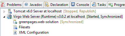

I downloaded greenpages-2.4.0 to take it for a sping in Eclipse Indigo + Virgo 3.0.2.
I imported the "solution" directory as a Maven project and then added it to the Virgo thanks to its server adapter.
index.php/fa/6587/0/
No luck. The error log file says this:
