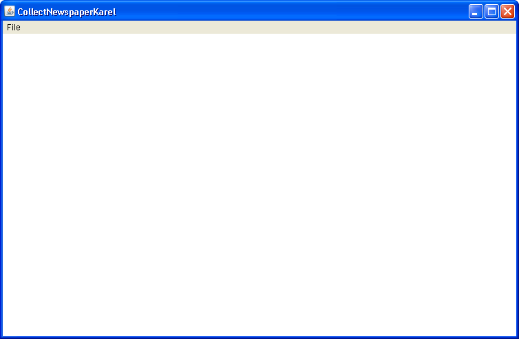

index.php/fa/6371/0/index.php/fa/6371/0/Hi!
I am a beginner and I cant run Karel the robot(from the CS106A Stanford class)in Eclipse on Windows XP.After I run CollectNewspaperKarel.java, I get a blank screen shown on the picture.
I also tried Indigo version but I got the same thing.
Could you please help me?
Thanks,John

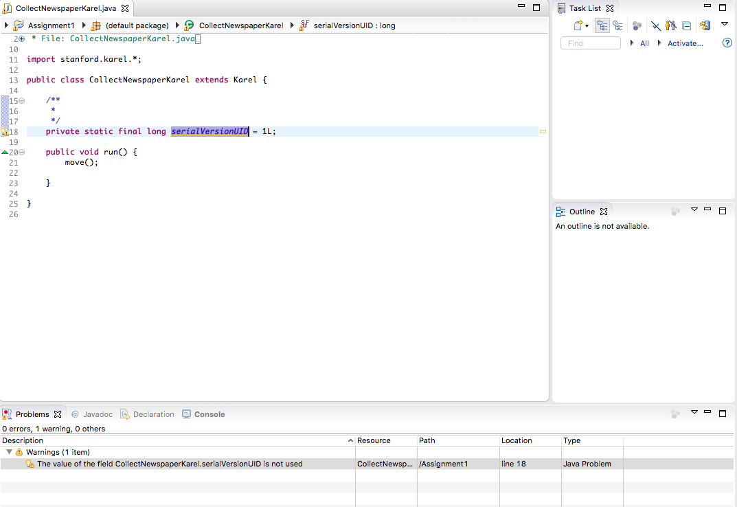

Re: Cant run Karel the robot or other kinds of programs in Eclipse [message #1779327 is a reply to message #1740100] Fri, 05 January 2018 07:46 Go to previous messageGo to next message
Hi Casey,
I had the similar problem as John, and did what you suggested but the blank window bug still occurs, with another error appearing (see the screenshot). Do you know anything about this?
Thaaaaanks
