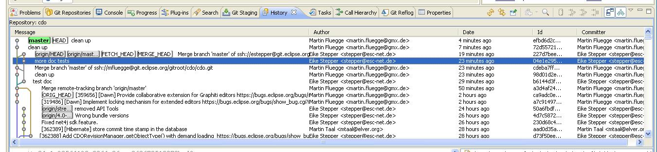

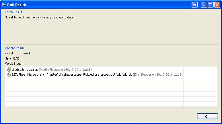

I committed two changes to my "master" and then pulled from the remote repository. After this operation pushing was prohibited because the merge operation during the pull was not able to merge the changes (see attached images). I found out that egit per default uses "resolve" as merge strategy. Trying a "merge" on the git bash was able to merge the different changes because it was using "recursiv" as merge strategy.
Is there a way to change the default merge strategy egit uses?
Thanks in advance.

Martin Fluegge skrev 2011-10-30 13.3925:
> Hi,
At the moment EGit does not have the recursive merge strategy. The reason
is that initially we did not have rename detection. Now, we do. so adding
the recursive merge should be fairly simple.
-- robin
